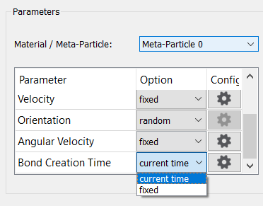

Bonds are created based on two methods - ‘current time’ or ‘fixed’. Once the bond model V2 is selected, these options are displayed in the Factory creating the Bulk Material or Meta-Particles. Current time allows the dynamic creation of bonded materials and fixed time allows the creation of bonded material at one user-defined point in time.
If the Bulk Material Active Bonds are defined and the Particles that comprise of the Bulk Material are in contact at the bond creation time, the bonds are formed according the bond parameters. This occurs once per simulation for each particle pair. Once the bond time has passed no new bonds will be formed.
You also have the option to use a custom API factory to create material and use the Bonding V2 model. The API factory can be set to assign a Custom Property with name CREATIONTIME = "Bond Creation Time”. The factory must then assign a value to the custom property equal to the current simulation time. EDEM will then create bonds between particles if the particles are in contact and both particles have a Custom Property CREATIONTIME value equal to the current simulation time. The custom property must be defined with 1 element and unit of eTime.

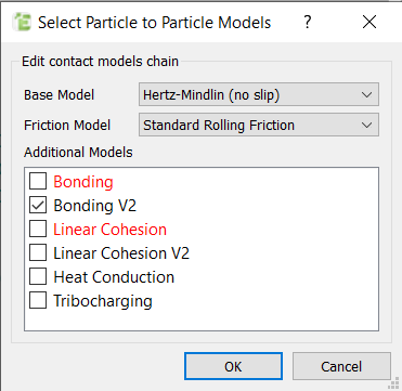

These bond forces/torques are in addition to the Base Contact Model. Since the bonds involved in this model can act when the particles are no longer physically in contact, the contact radius should be set to higher than the actual radius of the spheres. This model may only be used between particles.

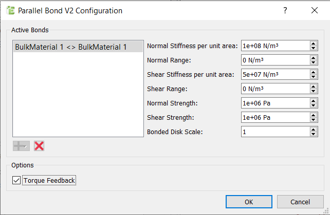

| Interaction | Configurable Parameters | Positiion |
| Particle to Particle |
Select an active bond then set the Bond Formation method and the following parameters: Normal Stiffness per unit area: the tensile/compressive stiffness along the bond’s principal axis. Set the bond stress and stiffness values to represent the material that is been modeled. A high stiffness value will produce high bond forces and stresses. A lower than normal Time Step may be required to accurately capture these high forces. When the Bond Formation Time is reached, all defined particles in contact will be bonded together. Before this time, particles interact based on the Hertz-Mindlin contact model. A bond between two particles will cease to exist whenever one or both of the bonded particles leaves the simulation domain. If periodic boundaries are applied when the particle leaves the domain, then the particle will exist on the opposite side of the domain; in this case the two particles will remain bonded across the periodic boundary. When Torque Feedback is selected the bonded structure has a greater resistance to bending when considering a bond between two spheres, for a bonded structure where rotation is limited this setting has less impact. |
