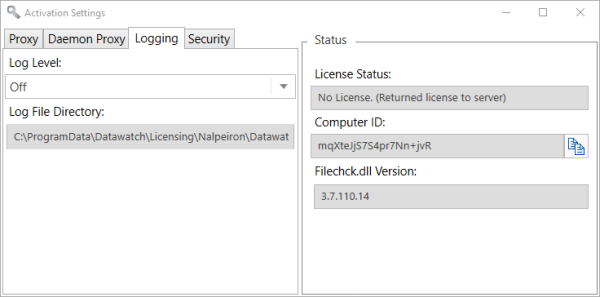

Depending on your license code, log files for activation settings in Monarch License Manager may be found in C:\ProgramData\Datawatch\Licensing\Nalpeiron\Datawatch Monarch 18 or C:\ProgramData\Datawatch\Licensing\Nalpeiron\Datawatch Monarch Subscription. You can change the amount of information provided in the log files via the Logging tab of the Activation Settings window.

Click Settings at the lower left-hand corner of the screen.
In the Activation Settings window that displays, select the Logging tab.
From the drop-down menu, select a log level.
Off
Errors Only
Errors and warnings
Errors, warnings, info, and debug
The Activate License screen displays.
Accepted values include:
You must restart the application for the settings specified in the Settings window activation come into effect
