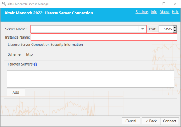

From the Choose License Method screen of the License Manager, ensure that the Connect to a Monarch License Server button is selected and then click Next.
The License Server Connection screen displays.
Enter the name of the License Server you wish to connect to in the Server Name field. Ensure that your port is correctly specified.

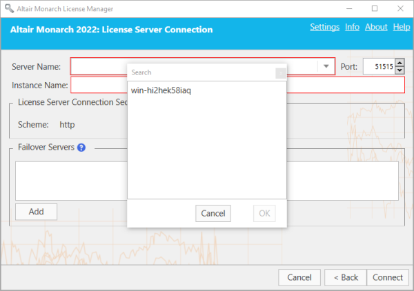

If you are unfamiliar with the name of the server to which you should connect, select the dropdown button located to the right of the Server Name field and then click Browse for all to launch a dialog that lists all available servers in your network. Select the server name you wish to connect to and then click OK.
Specify the instance name of the server to which you wish to connect.
Click Connect when you are done.

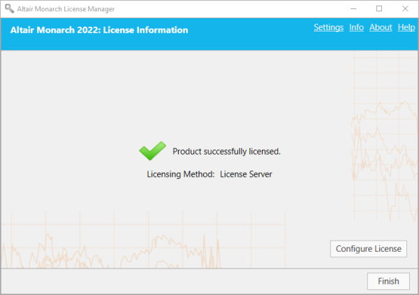

You may now run and use Monarch.
Upon successful connection, the following screen displays.

You can enter the server name manually or browse for it using the
button. Clicking the Browse for all item
that displays will open a Search window that
will show all available servers in your network. The instance
name is automatically defined as the instance name specified for
the main server. -
