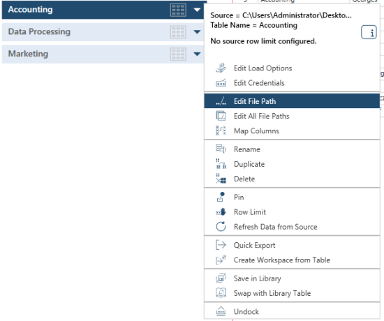

In the Prepare Window, click the drop-down arrow beside your table of interest and then select Edit File Path.

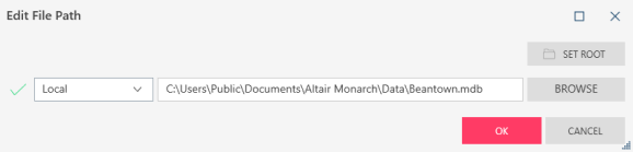

The Edit File Path dialog box displays.
Click the Browse button on this dialog to launch the Open dialog and locate the input source to replace your table with. By default, the directory last used for the specific provider displays. You can set a root folder from which to obtain the replacement data source by clicking on the Set Root button. Note that if a missing file is not located in this root folder, you will need to use the Browse button (Open dialog) to locate the file. In addition, selecting a file updates the provider's last used directory.
A checkmark displays to the left of the file path if the path you selected is a valid one.
Click OK when you are finished.

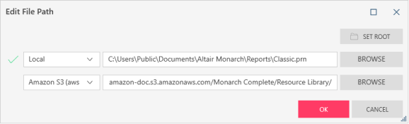

NOTE: If you edit the file path of a Monarch Report node, the Edit File Path dialog will include the paths of all reports (i.e., local and web) loaded in the node.

Select any table from the table selector, right-click on your mouse and then click Edit All File Paths.

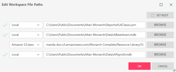

The Edit Workspace File Paths dialog displays.
Click the Browse button on this dialog to launch the Open dialog and locate input sources to replace your tables with. You can also set a root folder from which to obtain replacement data sources by clicking on the Set Root button.
Click OK to close the dialog and load the workspace correctly.
