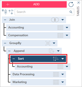

If we were to transform the table Append by grouping data, the resulting table will display on top of the Accounting, Data Processing, Marketing, and Append tables to indicate that a table with a new schema has been created from these three tables.
Thus, users are provided with a hierarchical view of all of the operations performed on a table; here, the most recent table is displayed at the top of the tree.
Note that load plans for sort operations behave differently from the load plans of other transformation operations. When a sort operation is applied to the Accounting table in the example above, the new sort table appears immediately over only the table of interest (i.e., the Accounting table), not the Group table, as might be expected with other transforms, and no new load plan is created.
This result is expected behavior because sorts do not change the schema of the original table.
When our sort definition is transformed by grouping, a new load plan is created, again because the schema of the resulting table (Group(1)) differs from that of the original table (Sort).
