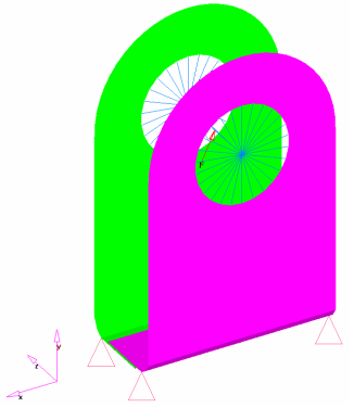

In this tutorial you will perform a size optimization on a welded bracket modeled with shell elements.
Figure 1. Structural Model of the Welded Bracket
You will load the structural model into HyperMesh. The constraints, loads, material properties, and subcases (loadsteps) are already defined in the model. Size design variables and optimization parameters are defined and the OptiStruct software determines the optimal gauges. The results are then reviewed in HyperMesh.

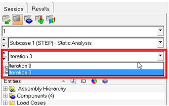

View the Results
Size optimization results from OptiStruct are given in two places. The bracket_size.out file contains gauge and volume information for all iterations. The bracket_size.h3d file contains the element thickness for all five iterations and Displacement and Stress results for the linear static analysis for iteration 0 and iteration 3. In this step you will review all results. The results contained in the HyperMesh binary results file will be examined first. The gauge history in the bracket_size.out file will then be reviewed.
