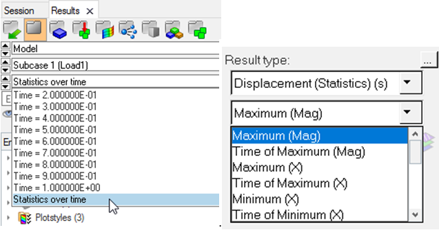

- Displacement Statistics are
supported for Direct and Modal Linear Transient Analysis types.
Only H3D output is supported for Displacement Statistics.
The following statistics over time are output for Transient Analysis when STATIS or OSTATIS is specified.- Statistics
- Supported Displacement Result Types
- Minimum and Time of Minimum
- X-component, Y-component, Z-component
- Maximum and Time of Maximum
- Magnitude, X-component, Y-component, Z-component
- Absolute Maximum and Time of Absolute Maximum
- Arithmetic Mean, Root Mean Square (RMS), Variance, and Standard Deviation
The displacement statistics can be viewed in HyperView after loading the H3D file, under Statistics over time option at the end of the timestep list in the Results Browser. Then, various statistics can be chosen from the sub-menu under Displacement (Statistics) (s).

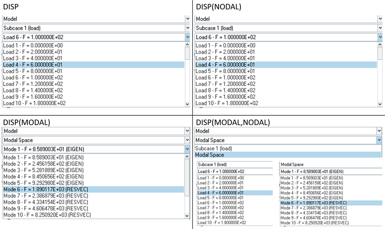

Figure 1. - In aeroelastic divergence analysis with multiple Mach numbers, only H3D output is available.
- If both MODAL
and NODAL options are present, then both eigenvector and
frequency/transient response results are output to the H3D, PCH, and OP2 files.
The output set IDs should match for both MODAL and
NODAL output.
