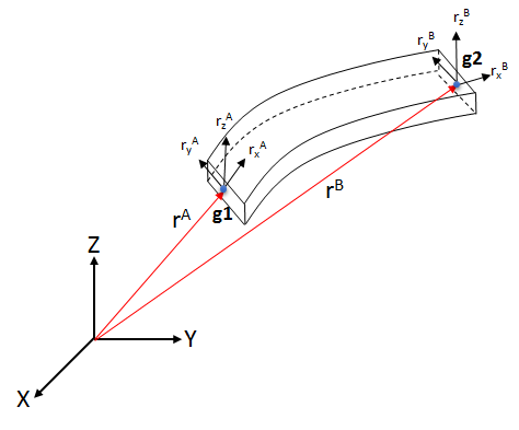

BEAM Elements
Figure 1. ANCF BEAM12 Element
- Position of the grid in 3D space
- Gradient vector in X direction
- Gradient vector in Y direction
- Gradient vector in Z direction
- Defines the axial strain in the X direction
- Defines the axial strain in the Y direction
- Defines the axial strain in the Z direction
- Degree of Freedom of the Grid
- Rigid translation of the grid along X axis

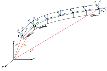

Figure 2. A Beam Modeled using Multiple BEAM12 Elements - Using a Rectangular and
Tubular Cross-SectionThe geometric properties of the BEAM12 element can be specified using the PBEAML element which lets you define the cross section of the beam along with the relevant dimensions. In addition to the geometric properties, you also need to specify material properties for the BEAM12 element. The BEAM 12 element supports linear elastic and hyper-elastic models that define the material model. For more information, please refer to the different material property elements in the documentation.

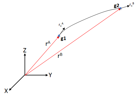

The second type of LINE element supported in MotionSolve is the CABLE element. Such a CABLE element can be considered a LINE element in that it is defined by two nodes - one at the start (g1) and one at the end (g2) of the element. This is illustrated in Figure 3.
Figure 3. ANCF CABLE Element
Based on the construction of this element, it is easy to see that it can only resist axial and bending loads. The cross section of this element is assumed to be constant and does not deform with increasing load.

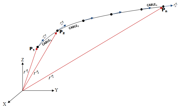

A wire or cable component can thus be modeled using multiple CABLE elements as shown in Figure 4.
Figure 4. Wire/cable Modeled using Multiple CABLE Elements
The geometric properties of the CABLE element can be specified using the PCABLE element which lets you define the cable cross section area, moment of area and other post processing flags. In addition to the geometric properties, you also need to specify material properties for the CABLE element. The CABLE element supports only the linear elastic material model. For more information, please refer to the documentation.
