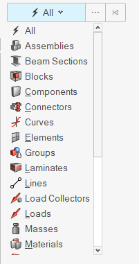

Entity Selectors
Use entity selectors to specify which type of entity you are able to select.
Entity selectors act as a filter by limiting your selection to a single entity type in the modeling window. For example, if an entity selector is set to Surfaces, only surface are available for selection. If it is set to Points, you can draw a window around the entire model and only the points will be selected. After performing a selection, the number of selected entities appears in parenthesis.
If a selector supports multiple entity types, click the arrow to view a drop-down menu of available options.
Entity selectors do not affect your selection in a browser. The entity selector in the modeling window will automatically update to match the selected entity type. You're also able to select multiple entities of different types in a browser.

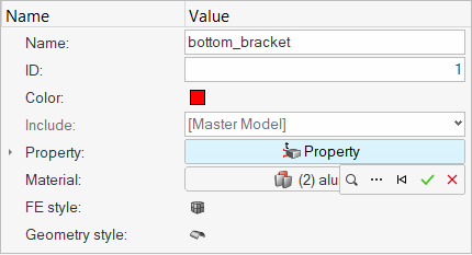

Select Entities from the Entity Editor
Figure 7.

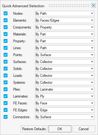

Quick Advanced Selection
Use quick advanced selection to associate a preferred advanced selection method to different entity types. The advanced method becomes instantly accessible while holding the Alt key during any selection action.
Appending and deselecting while using quick advanced selection is also possible via Alt + Ctrl and Alt + Shift, respectively.
Figure 8.

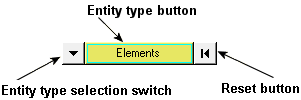

Select Entities Using Legacy Selectors
For older contexts, selection is performed via yellow entity selectors.
Figure 9.
An entity type in the plural form, such as "elements", indicates that you are able to select more than one entity from your model. An entity type in the singular form, such as "node", indicates that you can select only one entity from your model at a time.

Use the Extended Entity Selection Menu
Change the Entity Type
Click the entity type selection switch
to access a pop-up menu of possible entity types.
- Select the type that you want to use.
Reset the Selector
Card Filter
