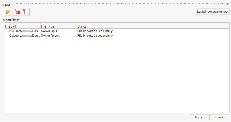

From the GeoD ribbon, I/O, and Prep group, select
Import. Figure 1.
The GeoD-Import dialog is displayed: Figure 2.

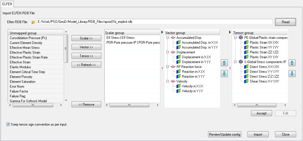

Convert Elfen Results

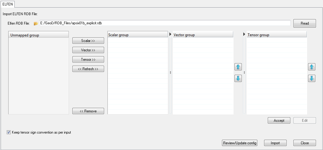

Launch Results Conversion Tool and select the
ELFEN tab from the window.
Upload .rdb elfen file in Elfen RDB
File field.Figure 3.
Select the Read button to populate all elfen result
files in the Unmapped group list.
The result files
are automatically grouped into Scalar,
Vector, and Tensor
groups depending on the input config file.Figure 4.
Note: User can group the result manually using the
Scalar, Vector, or
Tensor buttons.
Click the Accept button to confirm the mapped result
files.

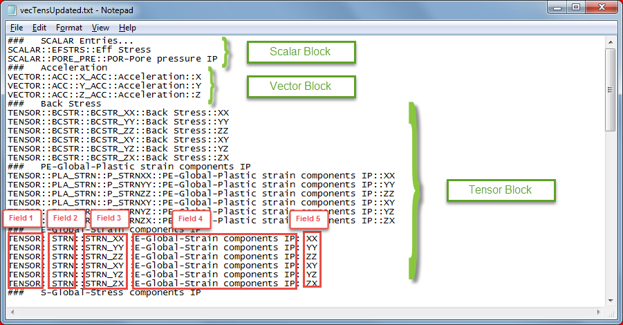

Click the Review/Update config button to review or
update the config file in text editor.
Figure 5.
Field 1: [Type Field] Identifier for the type of results to
group into ( Values: TENSOR, VECTOR, and SCALAR).
Field 2: [Group Field] A Unique name for the tensor/vector Group
to indicate components belong to that group (not included for
SCALAR).
Field 3: [ELFEN name Field] The name of the Result type that is
stored in the ELFEN Results file.
Field 4: [H3D name Field] The name of the Corresponding Result
type to use for the .h3d file.
Field 5: [Component Field] The Component of the Tensor/Vector
for that specific result type entry (not included for
SCALAR).

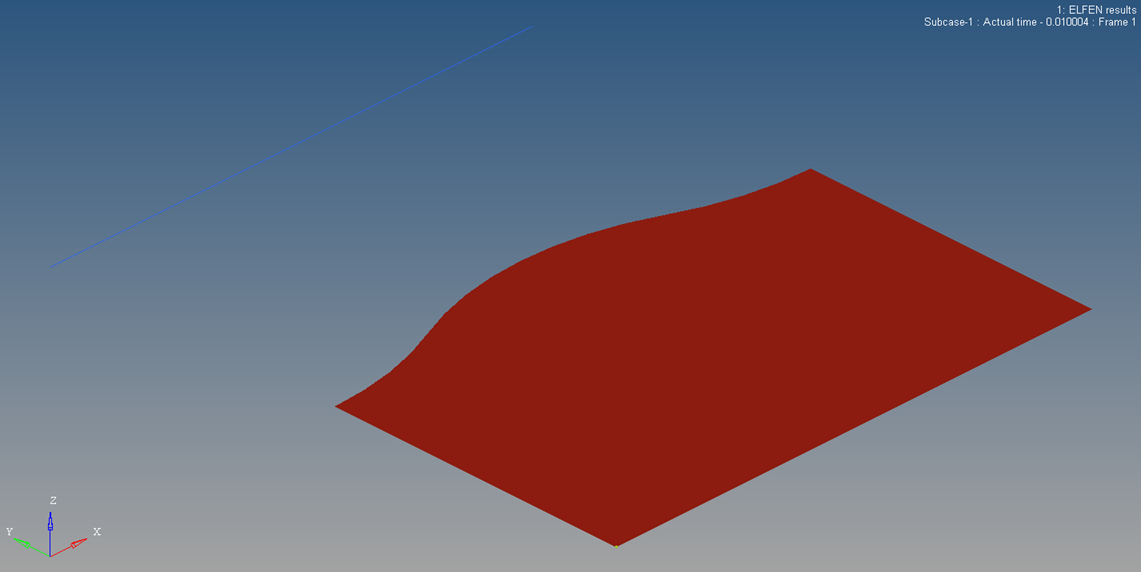

Click the Import button to open the converted result
file in HV.
The tool also converts and saves the
eflen.rdb file as h3d
file in the same input folder.Figure 6.
