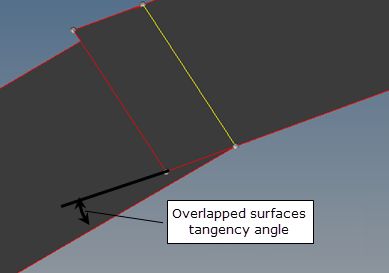

Fix overlaps with tangency angle <
Fix overlapping surfaces.
Auto
Calculate the tangency angle internally.
<value>
Enter a maximal tangency angle to fix overlapped surfaces.

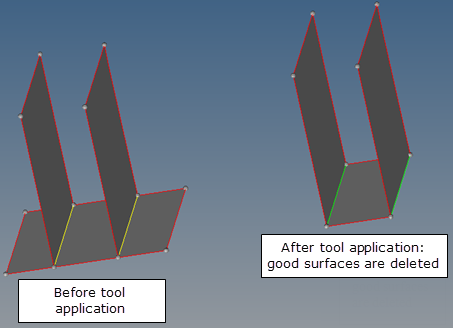

Figure 4. Overlapped Surfaces Tangency Angle

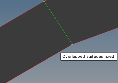

Figure 5. Overlapped Surfaces Fixed
Note: This option may remove the surfaces that should not be deleted. For example, it may happen to surfaces with T-connections. Setting the angle to < 45 may help reduce such side effects.
Figure 6. Possible Side Effects of Fixing Overlapped Surfaces

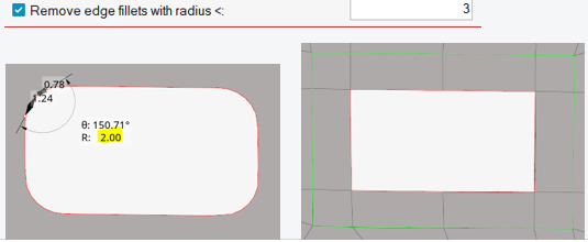

Remove edge fillets with radius <
Square off any fillets/rounded edges located on free edges and having radii below the specified value. This helps to create a good mesh pattern in such areas. For concave fillets, this means material is removed. For convex fillets, this means material is added.

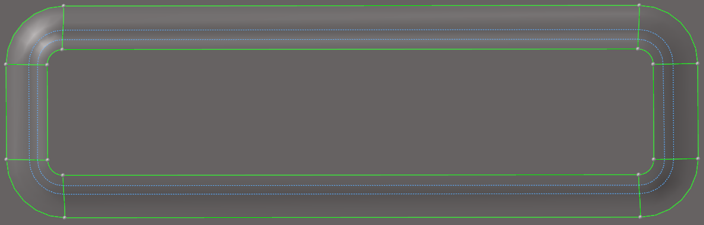

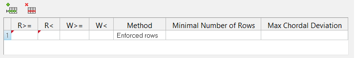

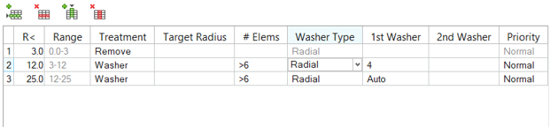

A table becomes enabled to define a desired number of element rows for specific ranges of average fillet radii, width, or both. Add/remove element rows by clicking (Add Row) and (Remove Row).
Figure 16.
Table 1. Surface Fillet Recognition Table Data
Column Action
R>= Minimum radius of the current fillet range.
R< Maximum radius of the current fillet range.
W>= Minimum width of the current fillet range.
Method Method used to treat fillets, such as remove, split and suppress, and enforce rows.
Minimal Number of Rows Number of elements across the width of the fillets for a given fillet radius.
Max Chordal Deviation Chordal deviation to be achieved while meshing.
Uniform fillet strips with an average radius between 3 and 5 and an average width between 2.0 to 9.0 will be meshed with one row of elements; uniform fillet strips with an average radius between 5 and 20 and an average width between 9.0 to 16.0 will be meshed with two rows of elements; and uniform fillets strips with an average radius between 20 and 30 and an average width between 16.0 to 24.0 will be meshed with three rows of elements. This rule does not apply to fillets with an average element width below or above the defined ranges of non-uniform fillet strips (when minimal and maximal width of fillets exceed 30%).
If the width or number of rows columns in the surface fillet recognition table are empty, the next default value will be applied. In this example, that means uniform fillet strips with an average fillet width between the element sizes of 0 to 2.0 will be meshed with one row of elements.
A fillet can be meshed with enforced rows of elements, or split at its midline and meshed accordingly based on element quality.

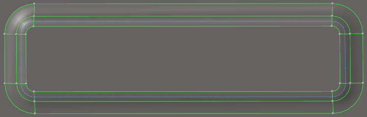

Geometry that represents flanges on sheet metal parts is recognized.
Flange recognition
Flanges may be modified to suppress construction lines, subdivide them into rectangular areas, or otherwise prepare them for proper meshing. As this functionality is not supported for solid geometries, it should be disabled for such models to improve performance.

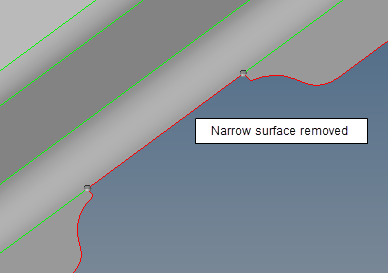

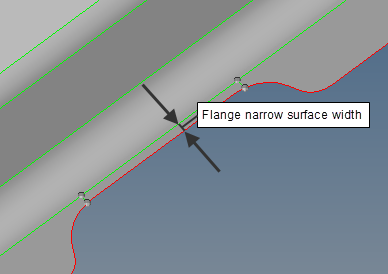

Delete flange narrow surfaces with width <
Controls the removal of narrow flange surfaces to avoid creation of sliver elements and disruptions in the mesh flow.
Auto
Delete narrow flange surfaces when the maximal narrow surface width is the minimum of 0.2*element_size and min_element_size.
<value>
Delete narrow flange surfaces when the maximal narrow surface width is the minimum of the specified value.
Figure 17. Flange Narrow Surface Width
Figure 18. Narrow Surface Removed

Circular hole recognition table data
Define radii ranges and additional options in the table.
Add/remove rows and columns by clicking: (Add Row), (Remove Row), (Add Column), (Remove Column).
Figure 24.
Table 2. Surface Hole Recognition Table Data
Column Action
R< Maximum radius of the current hole range. The minimum value is taken as 0.0 for the first row, or as the maximum value from the previous row. For slotted holes, the radius is measured at the tip of the hole.
Range Radius range for the current row. This value is read-only.
Treatment The manner in which you handle the following options:
Seed
Elements around hole
Remove
Removes the found hole
Washer
Creates washers around the hole
Mark
Creates a node and tag at center of hole
Target Radius Adjust holes in the range to have the specified target radius. The radius can be specified as an exact value, for example 5.0, or as an expression based on the original radius, for example radius*1.1, radius-0.5, radius+0.5.
# Elems Enter the minimum (for example, > 6) / exact (for example, 8) number of elements to create around the holes, or set to auto to automatically select the number of elements so that the min and max element size requirements are satisfied, with the best possible representation of the hole shape.
Washer Type Radial or Corner quad washer types are supported.
Table 2. Corner quad examples
Figure 25.
Figure 26.
Table 3. Radial examples
Figure 27.
Figure 28.
1st Washer/2nd Washer/3rd Washer Sets the width of the first, second, third washer as a constant value (select the blank entry in the drop down and enter a value), a scale of the hole radius, for example 0.6*radius, a subtraction formula, for example 14.0-radius, or an automatic determination based on element quality.
Note: If Auto for width is defined, in some cases washers will not be built if its not possible to have good washer elements.
Priority Set the priority of one radii range over the others. For example, to ensure all bolt holes (radii 10-15) have correct washers but other holes are not critical, holes with radii 10-15 will receive higher priority than others. This ensures that if two holes close to each other in the model have overlapping/conflicting washers, the hole with higher priority gets the washer while the other does not, or the hole with the lower priority may get a modified washer instead. In addition, when a hole is set to high priority, washer elements are not modified to correct for failed element quality. If a hole is set to normal priority, washer nodes are allowed to move to correct the quality.

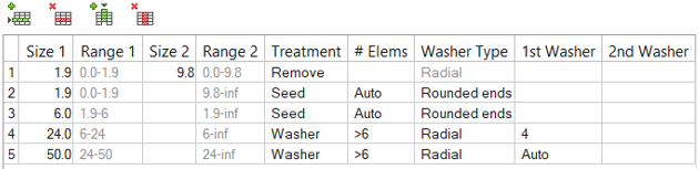

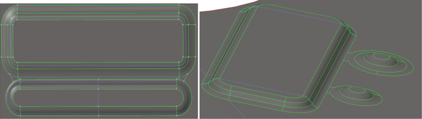

Slots Recognition Table Data
Define slot sizes and additional options in the table.
Figure 36.
Table 5. Surface Hole Recognition Table Data
Column Action

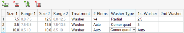

Size 1, Size 2 The size 1 and size 2 are defined as shown in the following image:
Figure 37.
Range 1, Range 2 Based on Size 1 and Size 2 entries, the ranges are auto filled so the sizes in between are considered properly.
Seed
Elements around circular ends of slot
Remove
Removes the found slot
Washer
Creates washers around the slot
Mark
Creates a node and tag at center of the hole
# Elems Enter the minimum (for example, > 6) /exact (for example 8) number of elements to create around the circular ends of the slots as shown below, or set to auto to automatically select the number of elements so that the min and max element size requirements are satisfied, with the best possible representation of the hole shape.
Figure 38. Number of elements defined = 8
Washer Type For seed, slots can have Rounded or Rectangular ends as shown below:
Table 5.
Rectangular Rounded
Figure 39.
Figure 40.
Note: If the option is “auto”, slot ends are meshed per the parameters defined in the hole table.

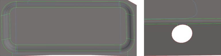

Rectangular/Square Hole Recognition Table Data
Define rectangular hole sizes and additional options in the table.
Figure 41.
Table 7. Rectangular/Square Hole Recognition Table Data
Column Action
Figure 42.
Seed
Remove
Washer
Mark
Note: Auto is not recommended for holes with washer layers.
Table 7.
Corner Quad Radial
Figure 43.
Figure 44.
Note: For rectangular holes with edge fillets as shown below, as long as edge fillet removal option is ON and those edge fillets are removed using this option, the rectangular shape is identified and treated.
Figure 45.

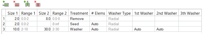

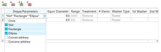

Mixed Hole Recognition Table Data
Define mixed hole sizes and additional options in the table. Various shapes can be combined and the equivalent diameter can be specified based on which the shapes will be identified and treated.
The equivalent diameter = perimeter of the hole shape / .
Figure 49.

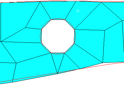

If circle, slot and rectangle is selected, then various washer treatment options are available. Currently other shapes are not supported.
For parameter files before version 2021.1 within circular holes table, slots were treated as well. Now that slots can be defined separately, the legacy files once loaded in the new version slots table is automatically filled based on the circular holes data. You have the flexibility to use this data or completely delete and add new data. The new data is populated based on following rule: If holes of certain radius are removed in the holes table, corresponding slots with same radius will be removed as long as slot length is shorter than 1.4 x target element size and width less than 95% minimum element size.
For example: Circular hole with radius 2.2 to be removed with min size 3 and target size 5.
Figure 50.
This will be populated in the slots table below as per the above-mentioned rule.
Figure 51.
Also, other mixed shapes tables will be populated with the equivalent diameter values with remove as the treatment.
Figure 52.

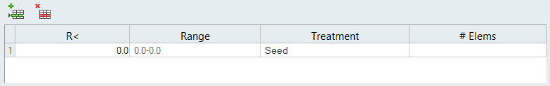

Holes 3D
Surface 2D holes are recognized and treated appropriately.
3D hole recognition
Surface holes of different sizes are recognized and treated appropriately. A table becomes enabled to define the radii ranges and additional options.
3D hole recognition table data
Define radii ranges and additional options in the table. Add/remove element rows by clicking (Add Row) and (Remove Row).
Figure 53.
Table 10. 3D Hole Recognition Table Data
Column Action
Seed
Elements around hole.
Remove
Removes the found hole.
Mark
Creates a node and tag at center of hole.
Remove and mark
Removes the found hole and creates a node and tag at the center of the hole.
# Elems Enter the minimum/exact number of elements to create around the holes, or set to auto to automatically select the number of elements so that the min and max element size requirements are satisfied, with the best possible representation of the hole shape.
Tip: Auto is not recommended for holes with washer layers.
