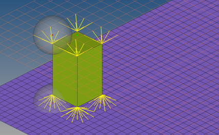

use rbe3 radius RBE3 elements are typically created with three or four legs dependent on the element type (quadface, triaface) the projection of the appropriate hexa node is landing on. To be more accurate, especially regarding different mesh sizes, an rbe3 radius can be defined, so that more nodes nodes can be joined by each RBE3 element. In any case, at least one element face will be joined by each RBE3 element.
Figure 1. use rbe3 radius Disabled
Figure 2. use rbe3 radius Enabled
All of the nodes of the appropriate link (outer nodes, if it is a solid link), which are positioned inside a sphere around the projection point, are considered to be joined to the RBE3 element. A feature angle is also considered. The nodes that are on a different side of the feature edge than the projection point will not be joined to the RBE3 element.

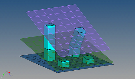

shell gap
Project the hexa spot to touch the shell elements.
The position is independent from any thickness.
equival. (T1+T2)/2
Create hexa elements with RBE3 elements projecting and connecting to the surrounding shell elements.
This realization uses the shell thickness to calculate the hexa offset from the shell elements. In the case where the model is a 3T connection, the acm (equivalenced-(T1+T2)/2) realization will join the hexa elements.

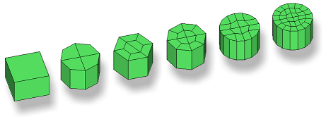

num hexas Create a hexa cluster with 1, 4, 8, 12, 16 or 32 hexas, which are arranged in a predefined pattern.
Figure 9.
Note: Available for all ACM realization types.

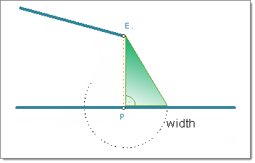

width Specifies the length of a penta.
Note: Available for: penta (mig + L), penta (mig + T), and penta (B).
depth Specifies the depth of a penta.
fitted/equilateral/ equilateral-fitted
Select the size and shape of a penta.

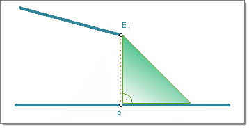

fitted
The length of one penta edge is the exact projection distance, and the length of the other penta edge is defined by the width value; the penta has an right-angle.
Figure 11. Example: Fitted

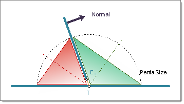

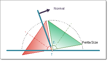

right-angled
Create a right-angled penta that is oriented around the bisector. Clear this checkbox to create an angle adapted penta.
Figure 14. Right-Angled T-weld Penta Created on Both Sides of the Normal
Figure 15. Angle Adapted T-weld Penta Created on Both Sides of the Normal
Note: Available for: penta (mig + T).
both sides/positive sides/negative sides
Select which side of the normal to create the penta on.
(mig + L)
The negative side is the side where the links are fairly parallel to each other. The angle that is close to 90° (88° to 90°) the element normal of the first found shell element at the free edge decides which side is the positive and the negative side.
Figure 16. Example: (mig + L)
(mig + T)
The positive side is normally the side with the obtuse angle. The angle that is close to 90° (88° to 92°) the element normal of the first found shell element at the free edge decides which side is the positive and negative side.
Figure 17. Example: (mig + T)
(mig + B)
The positive side is the side where the element normal of the first link points to.
Figure 18. Example: (mig + B)
