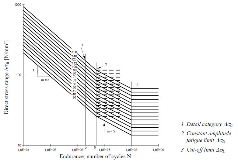

Fatigue Limit Slope - Normal Stress (Md)
Slope of the curve at the fatigue limit for normal stress components of tensor. Refer to location 2 in the graph.
Fatigue Limit Slope - Shear Stress (Md)
Slope of the curve at the fatigue limit for shear stress components of tensor. Refer to location 2 in the graph.
Cutoff Limit Slope - Normal Stress (Ml)
Slope of the curve at the cutoff limit for normal stress components of tensor. Refer to location 3 in the graph.
Cutoff Limit Slope - Shear Stress (Ml)
Slope of the curve at the cutoff limit for shear stress components of tensor. Refer to location 3 in the graph.
Number of Cycles at Fatigue Limit (Nd)
Number of cycles in the S-N curve at the fatigue limit.
Number of Cycles at Cutoff Limit (Nd)
Number of cycles in the S-N curve at the cutoff limit.

Weld Detail Category - Transverse Location_X
Weld detail category from the image below that will be considered for the calculation of fatigue and cutoff limits of the normal stress component in the transverse direction (perpendicular to the axis of the weld) at ‘X’.
Weld Detail Category - Longitudinal Location_X
Weld detail category from the image below that will be considered for the calculation of fatigue and cutoff limits of the normal stress component in the longitudinal direction (parallel to the axis of the weld) at ‘X’.
Weld Detail Category - Shear Location_X
Weld detail category from the image below that will be considered for the calculation of fatigue and cutoff limits of the shear stress component at ‘X’.

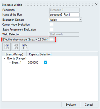

If effective stress range is enabled in evaluation to account for mean stress influence on fatigue strength for non-welded and stress-relieved welds, then stress range is calculated as shown below:
 Δσ(Effective Stress Range)= |  σ max  |+ 0.6 |  σ min  | MathType@MTEF@5@5@+= feaahqart1ev3aaatCvAUfeBSjuyZL2yd9gzLbvyNv2CaerbuLwBLn hiov2DGi1BTfMBaeXatLxBI9gBaerbd9wDYLwzYbItLDharqqtubsr 4rNCHbGeaGqiVu0Je9sqqrpepC0xbbL8F4rqqrFfpeea0xe9Lq=Jc9 vqaqpepm0xbba9pwe9Q8fs0=yqaqpepae9pg0FirpepeKkFr0xfr=x fr=xb9adbaqaaeGaciGaaiaabeqaamaabaabaaGcbaaeaaaaaaaaa8 qacaGGGcWdaiabfs5aejabeo8aZjaacIcacaWGfbGaamOzaiaadAga caWGLbGaam4yaiaadshacaWGPbGaamODaiaadwgacaaMe8Uaam4uai aadshacaWGYbGaamyzaiaadohacaWGZbGaaGjbVlaadkfacaWGHbGa amOBaiaadEgacaWGLbGaaiykaiabg2da9iaaysW7caGG8bGaaGjbVl abeo8aZnaaBaaaleaaciGGTbGaaiyyaiaacIhaaeqaaOGaaGjbVlaa cYhacqGHRaWkcaaMe8UaaGimaiaac6cacaaI2aGaaGjbVlaacYhaca aMe8Uaeq4Wdm3aaSbaaSqaaiGac2gacaGGPbGaaiOBaaqabaGccaaM e8UaaiiFaaaa@6DCF@
Fatigue Limit Calculation (ΔσD)
For Normal Component: Δ σ D =Δ σ c · ( 2,0e+6 N D ) (1/ m D ) MathType@MTEF@5@5@+= feaagKart1ev2aaatCvAUfeBSjuyZL2yd9gzLbvyNv2CaerbuLwBLn hiov2DGi1BTfMBaeXatLxBI9gBaerbd9wDYLwzYbItLDharqqtubsr 4rNCHbGeaGqiVu0Je9sqqrpepC0xbbL8F4rqqrFfpeea0xe9Lq=Jc9 vqaqpepm0xbba9pwe9Q8fs0=yqaqpepae9pg0FirpepeKkFr0xfr=x fr=xb9adbaqaaeGaciGaaiaabeqaamaabaabaaGcbaGaeuiLdqKaeq 4Wdm3aaSbaaSqaaiaadseaaeqaaOGaeyypa0JaeuiLdqKaeq4Wdm3a aSbaaSqaaiaadogaaeqaaOGaeS4JPF2aaeWaaeaadaWcaaqaaiaaik dacaGGSaGaaGimaiaadwgacqGHRaWkcaaI2aaabaGaamOtamaaBaaa leaacaWGebaabeaaaaaakiaawIcacaGLPaaadaahaaWcbeqaaiaacI cacaaIXaGaai4laiaad2gadaWgaaadbaGaamiraaqabaWccaGGPaaa aaaa@4EDF@
For Shear Component: Δ σ D = ∞ MathType@MTEF@5@5@+= feaagKart1ev2aaatCvAUfeBSjuyZL2yd9gzLbvyNv2CaerbuLwBLn hiov2DGi1BTfMBaeXatLxBI9gBaerbd9wDYLwzYbItLDharqqtubsr 4rNCHbGeaGqiVu0Je9sqqrpepC0xbbL8F4rqqrFfpeea0xe9Lq=Jc9 vqaqpepm0xbba9pwe9Q8fs0=yqaqpepae9pg0FirpepeKkFr0xfr=x fr=xb9adbaqaaeGaciGaaiaabeqaamaabaabaaGcbaGaeuiLdqKaeq 4Wdm3aaSbaaSqaaiaadseaaeqaaOGaeyypa0JaeyOhIukaaa@3C95@
Where:
  • Δσc - Corrected stress range value
  • ND - Number of cycles at fatigue limit
  • mD - Slope at fatigue limit
Cutoff Limit Calculation (ΔσL)
For Normal Component: Δ σ L =Δ σ D · ( N D N L ) (1/ m L ) MathType@MTEF@5@5@+= feaagKart1ev2aaatCvAUfeBSjuyZL2yd9gzLbvyNv2CaerbuLwBLn hiov2DGi1BTfMBaeXatLxBI9gBaerbd9wDYLwzYbItLDharqqtubsr 4rNCHbGeaGqiVu0Je9sqqrpepC0xbbL8F4rqqrFfpeea0xe9Lq=Jc9 vqaqpepm0xbba9pwe9Q8fs0=yqaqpepae9pg0FirpepeKkFr0xfr=x fr=xb9adbaqaaeGaciGaaiaabeqaamaabaabaaGcbaGaeuiLdqKaeq 4Wdm3aaSbaaSqaaiaadYeaaeqaaOGaeyypa0JaeuiLdqKaeq4Wdm3a aSbaaSqaaiaadseaaeqaaOGaeS4JPF2aaeWaaeaadaWcaaqaaiaad6 eadaWgaaWcbaGaamiraaqabaaakeaacaWGobWaaSbaaSqaaiaadYea aeqaaaaaaOGaayjkaiaawMcaamaaCaaaleqabaGaaiikaiaaigdaca GGVaGaamyBamaaBaaameaacaWGmbaabeaaliaacMcaaaaaaa@4BF8@
For Shear Component: Δ σ L =Δ σ c · ( 2,0e+6 N L ) (1/ m L ) MathType@MTEF@5@5@+= feaagKart1ev2aaatCvAUfeBSjuyZL2yd9gzLbvyNv2CaerbuLwBLn hiov2DGi1BTfMBaeXatLxBI9gBaerbd9wDYLwzYbItLDharqqtubsr 4rNCHbGeaGqiVu0Je9sqqrpepC0xbbL8F4rqqrFfpeea0xe9Lq=Jc9 vqaqpepm0xbba9pwe9Q8fs0=yqaqpepae9pg0FirpepeKkFr0xfr=x fr=xb9adbaqaaeGaciGaaiaabeqaamaabaabaaGcbaGaeuiLdqKaeq 4Wdm3aaSbaaSqaaiaadYeaaeqaaOGaeyypa0JaeuiLdqKaeq4Wdm3a aSbaaSqaaiaadogaaeqaaOGaeS4JPF2aaeWaaeaadaWcaaqaaiaaik dacaGGSaGaaGimaiaadwgacqGHRaWkcaaI2aaabaGaamOtamaaBaaa leaacaWGmbaabeaaaaaakiaawIcacaGLPaaadaahaaWcbeqaaiaacI cacaaIXaGaai4laiaad2gadaWgaaadbaGaamitaaqabaWccaGGPaaa aaaa@4EF7@
Where:
  • ΔσD - Fatigue limit stress value
  • NL - Number of cycles at cutoff limit
  • mL - Slope at cutoff limit
Permissible Number of Cycles (Nperm)
If Δσ≥Δ σ D                                                                         N perm = N D · ( Δσ Δ σ D ) ( − m D ) If Δ σ D >Δσ≥Δ σ L                                                                         N perm = N L · ( Δσ Δ σ L ) ( − m L ) If Δσ<Δ σ L                                                                         N perm =∞ MathType@MTEF@5@5@+= feaagKart1ev2aaatCvAUfeBSjuyZL2yd9gzLbvyNv2CaerbuLwBLn hiov2DGi1BTfMBaeXatLxBI9gBaerbd9wDYLwzYbItLDharqqtubsr 4rNCHbGeaGqiVu0Je9sqqrpepC0xbbL8F4rqqrFfpeea0xe9Lq=Jc9 vqaqpepm0xbba9pwe9Q8fs0=yqaqpepae9pg0FirpepeKkFr0xfr=x fr=xb9adbaqaaeGaciGaaiaabeqaamaabaabaaGceaqabeaacaqGjb GaaeOzaiaabccacqqHuoarcqaHdpWCcqGHLjYScqqHuoarcqaHdpWC daWgaaWcbaGaamiraaqabaaakeaacaaMe8UaaGjbVlaaysW7caaMe8 UaaGjbVlaaysW7caaMe8UaaGjbVlaaysW7caaMe8UaaGjbVlaaysW7 caaMe8UaaGjbVlaaysW7caaMe8UaaGjbVlaaysW7caaMe8UaaGjbVl aaysW7caaMe8UaaGjbVlaaysW7caaMe8UaaGjbVlaaysW7caaMe8Ua aGjbVlaaysW7caaMe8UaaGjbVlaaysW7caaMe8UaaGjbVlaaysW7ca aMe8UaaGjbVlaaysW7caaMe8UaaGjbVlaaysW7caaMe8UaaGjbVlaa ysW7caaMe8UaaGjbVlaaysW7caaMe8UaaGjbVlaaysW7caaMe8UaaG jbVlaaysW7caaMe8UaaGjbVlaaysW7caaMe8UaaGjbVlaaysW7caaM e8UaaGjbVlaaysW7caaMe8UaaGjbVlaaysW7caaMe8UaaGjbVlaays W7caaMe8UaaGjbVlaad6eadaWgaaWcbaGaamiCaiaadwgacaWGYbGa amyBaaqabaGccqGH9aqpcaWGobWaaSbaaSqaaiaadseaaeqaaOGaeS 4JPF2aaeWaaeaadaWcaaqaaiabfs5aejabeo8aZbqaaiabfs5aejab eo8aZnaaBaaaleaacaWGebaabeaaaaaakiaawIcacaGLPaaadaahaa WcbeqaamaabmaabaGaeyOeI0IaamyBamaaBaaameaacaWGebaabeaa aSGaayjkaiaawMcaaaaaaOqaaiaabMeacaqGMbGaaeiiaiabfs5aej abeo8aZnaaBaaaleaacaWGebaabeaakiabg6da+iabfs5aejabeo8a ZjabgwMiZkabfs5aejabeo8aZnaaBaaaleaacaWGmbaabeaaaOqaai aaysW7caaMe8UaaGjbVlaaysW7caaMe8UaaGjbVlaaysW7caaMe8Ua aGjbVlaaysW7caaMe8UaaGjbVlaaysW7caaMe8UaaGjbVlaaysW7ca aMe8UaaGjbVlaaysW7caaMe8UaaGjbVlaaysW7caaMe8UaaGjbVlaa ysW7caaMe8UaaGjbVlaaysW7caaMe8UaaGjbVlaaysW7caaMe8UaaG jbVlaaysW7caaMe8UaaGjbVlaaysW7caaMe8UaaGjbVlaaysW7caaM e8UaaGjbVlaaysW7caaMe8UaaGjbVlaaysW7caaMe8UaaGjbVlaays W7caaMe8UaaGjbVlaaysW7caaMe8UaaGjbVlaaysW7caaMe8UaaGjb VlaaysW7caaMe8UaaGjbVlaaysW7caaMe8UaaGjbVlaaysW7caaMe8 UaaGjbVlaaysW7caaMe8UaaGjbVlaaysW7caaMe8UaamOtamaaBaaa leaacaWGWbGaamyzaiaadkhacaWGTbaabeaakiabg2da9iaad6eada WgaaWcbaGaamitaaqabaGccqWIpM+zdaqadaqaamaalaaabaGaeuiL dqKaeq4WdmhabaGaeuiLdqKaeq4Wdm3aaSbaaSqaaiaadYeaaeqaaa aaaOGaayjkaiaawMcaamaaCaaaleqabaWaaeWaaeaacqGHsislcaWG TbWaaSbaaWqaaiaadYeaaeqaaaWccaGLOaGaayzkaaaaaaGcbaGaae ysaiaabAgacaqGGaGaeuiLdqKaeq4WdmNaeyipaWJaeuiLdqKaeq4W dm3aaSbaaSqaaiaadYeaaeqaaaGcbaGaaGjbVlaaysW7caaMe8UaaG jbVlaaysW7caaMe8UaaGjbVlaaysW7caaMe8UaaGjbVlaaysW7caaM e8UaaGjbVlaaysW7caaMe8UaaGjbVlaaysW7caaMe8UaaGjbVlaays W7caaMe8UaaGjbVlaaysW7caaMe8UaaGjbVlaaysW7caaMe8UaaGjb VlaaysW7caaMe8UaaGjbVlaaysW7caaMe8UaaGjbVlaaysW7caaMe8 UaaGjbVlaaysW7caaMe8UaaGjbVlaaysW7caaMe8UaaGjbVlaaysW7 caaMe8UaaGjbVlaaysW7caaMe8UaaGjbVlaaysW7caaMe8UaaGjbVl aaysW7caaMe8UaaGjbVlaaysW7caaMe8UaaGjbVlaaysW7caaMe8Ua aGjbVlaaysW7caaMe8UaaGjbVlaaysW7caaMe8UaaGjbVlaaysW7ca aMe8UaaGjbVlaaysW7caWGobWaaSbaaSqaaiaadchacaWGLbGaamOC aiaad2gaaeqaaOGaeyypa0JaeyOhIukaaaa@DDC3@
