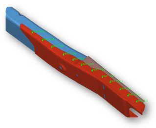

Connectors are geometric entities (not FE) used to create connections between components. Connectors are used to realize
FE idealizations of the physical connection. Just as you create an FE mesh on a surface, you create FE connections
by realizing a connector.
There are many advantages to the way connectors store information. Not only does this local storage allow you to edit
the connector definition, it also allows you to review connector details and the quality of the realization.
Most of the information stored in the connector entity can be exported to a master connectors file, which contains
connector entity information such as location, link entity, link entity state, link entity rules. The exported file
may also contain metadata information stored in the connector.

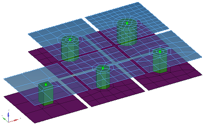

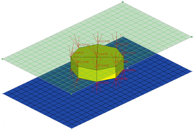

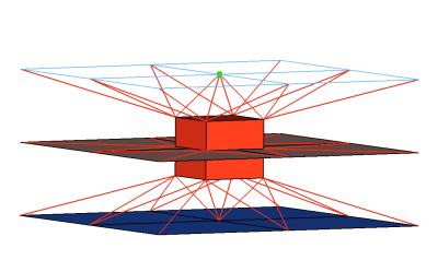

Creates hexa element with DCOUP3D elements projecting and connecting to the
surrounding shell elements. This realization uses the shell thickness to calculate the
hexa offset from the shell elements. In the case where the model is a 3T connection, the
acm (equivalenced-(T1+T2)/2) realization will join the hexa elements.
This realization uses the prop_abaqus_acm.tcl4 property script. Figure 2.

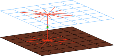

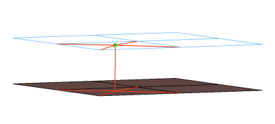

Creates DCOUP3D elements for the head and element for the body. The head elements
project and connect to the nodes of the adjoining shell elements. Figure 3.
Creates KINCOUP elements for the head and element for the body. The head elements
project and connect to the nodes of the adjoining shell elements. Figure 4.

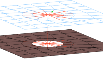

Abaqus bolt (b31)
Creates KINCOUP elements for the head and B31 element for the body. The head elements
project and connect to the nodes of the adjoining shell elements that form the hole, and
also to the second row of nodes to form the washer layer. The connector location can be
on the edge of the hole, center of the hole, midpoint in between the two, holes or on
the second row of nodes which form the washer layer.
This connector also uses the script prop_abaqus_b31.tcl3. Figure 5.

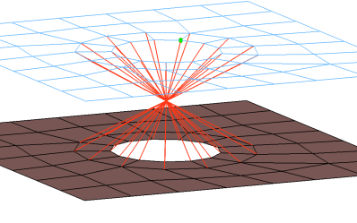

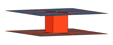

Creates KINCOUP elements for the head and B31 element for the body. The rot x degree
of freedom is constrained. The head elements project and connect to the nodes of the
adjoining shell elements that form the hole, and also to the second row of nodes to form
the washer layer. The connector location can be on the edge of the hole, center of the
hole, midpoint in between the two holes, or on the second row of nodes which form the
washer layer.
This connector also uses the script prop_abaqus_b31.tcl3. Figure 6.

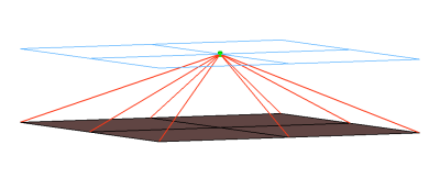

Creates a KINCOUP element. The element projects and connects to the nodes of the
adjoining shell elements that form the hole, and also the nodes that form the washer
layer. The connector location can either be on the edge of the hole, center of the hole,
midpoint in between the two holes, or on the second row of nodes which form the washer
layer. Figure 9.

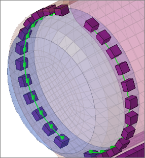

Creates KINCOUP elements for the head and body. The head elements project and connect
to the nodes of the adjoining elements, forming the hole and also the second row of
nodes which form the washer layer. The connector location can either be on the edge of
the hole, center of the hole, midpoint in between the two holes, or on the second row of
nodes which form the washer layer. Figure 14.

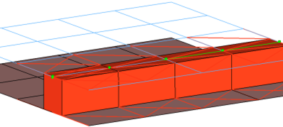

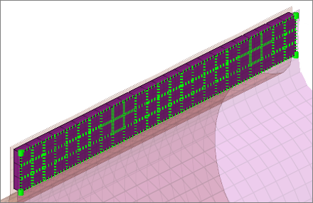

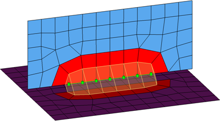

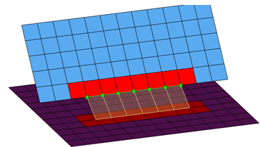

Creates a quad row with tria caps at the seam ends. In addition, a certain pure quad
element pattern is created around the seam elements, shown here in red. These elements
normally get imprinted into the shell links. The exact geometry of the seam can be
influenced by certain attributes in the Seam panel.
This realization is mainly intended to be used for lap welds.
Note: You can revert the
direction of quad seam connectors during the next realization by activating the
reverse direction checkbox in the Seam panel.

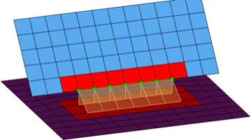

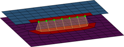

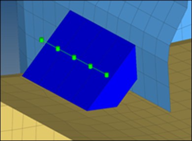

Creates one quad row under a certain angle. The angle is measured between the quad row
and the perpendicular projection from the free edge to the opposite shell link. In
addition, a certain pure quad element pattern is created around the seam elements, shown
here in red. These elements normally get imprinted into the shell links. The exact
geometry of the seam can be influenced by the angle value.
This realization is can be used for both, lap- and T-welds.

Abaqus hexa (adhesive)
Creates a row of hexa elements for the body, and numerous DCOUP3D elements for the
head. The head elements project and connect to the nodes of the adjoining shell/solid
elements. The hexa elements are projected so that they touch the shell/solid elements of
the connecting components.
This realization also uses the prop_abaqus_acm.tcl4 property script. Figure 27.
Creates perpendicular and parallel vectors to the surface along a line/nodelist. On
exporting the connector file, a vector file (.asc format)
containing the vector information is also exported for this realization. Figure 28.
Intended to be used for t-cases. The size and exact position can be defined thickness
dependent, or the exact dimension and position parameters can be given. Figure 29.

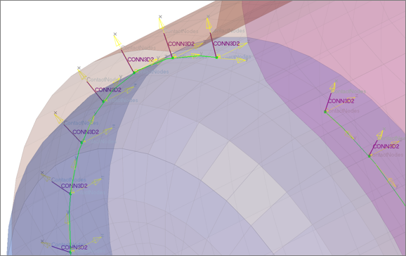

This realization uses the prop_fastener_nodes.tcl1 property script. Figure 30.
Figure 31.

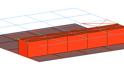

Creates hexa (C3D8) elements between shell and/or solid elements in order to connect
them using a tie contact definition. The hexa element nodes will project and touch the
shell and/or solid element faces. During the realization, a default tie contact and
referencing main and secondary surfaces are created; unless defined differently, the hexas
are assigned a default property and material, and are organized into a component with
the same name base as the property.

prop_abaqus_acm.tcl
Used while creating acm
(equivalenced-(T1+T2)/2) / (detached-(T1+T2)/2) /shell gap in the Spot panel and
adhesives in the Area panel. It performs the following tasks.
Organizes the realized weld elements [acm Equivalence-(T1+T2/2)] into the
respective components based upon the *HEAD and the *BODY information of the weld.
During realization of this configuration type a solid hexa element [C3D8] is
connected to the shell elements by the rbe3 elements [DCOUP3D].
A collector with the name C3D8_comp_<id> is created with the SOLIDSECTION
card image associated with it. This component contains all of the solid C3D8
elements which are created during realization.
A collector with the name DCOUP3D_comp_<id> is created, containing all of
the DCOUP3D elements created as the heads to the weld element.

prop_fastener.tcl
Used while creating Abaqus Fasteners in the Spot panel. It performs the following
tasks.
Organizes the realized weld elements into their respective components, based
upon the link they are connected to. Thus, if a weld is created between comp_1(1)
and comp_2(2), the script creates a component collector with the name
HM_CONN3D2<id> and organizes all the welds created as links between these two
components into this collector. This collector is later referenced as the element
set while creating the Groups (Interfaces).
Creates the following properties/materials collectors:
HM_ConnectorBehavior<id>
This material collector is created with the *CONNECTOR BEHAVIOR card
associated with it.
HM_ConnectionSection_<id>
This property collector is created once per model (card image CONNECTOR
SECTION). The property is assigned to each HM_CONN3D2 component collector
and carries the material HM_ConnectorBehavior.
HM_FastenerProperty_r_<radius in property>
This property collector is created with the *FASTENER PROPERTY card
associated with it. It defines the RADIUS and the degree of freedom
definition of the fastener.
Creates Groups (HM Interfaces) with the name HM_FastenerInteraction<id> and
with the *FASTENER card associated with it. The fastener connects two component
collectors and refers to the fastener property card mentioned above. It can also
show the link elements to which the weld elements are linked via the
Automatic_Surface_from_components option.
If any system option (Single System ,1- System per layer or 2- Systems per
layer) is used in the Spot panel during realization, this script creates
ORIENTATION systems in the current collector with the name
HM_ORI<weld_id>_n<node_id>. A property HM_ConnectorSection_<CONN3D2
element id> is created and assigned per element. Depending on whether one or
two systems per layer are created the property points to one or both
systems.
