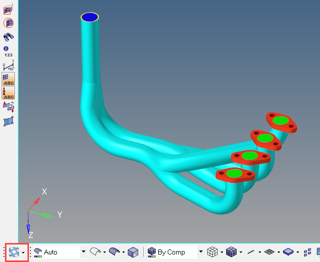

Figure 1. Schematic of Exhaust Manifold
The diameter of the inlets is 0.036 m; the inlet velocity (v) is 8.0 m/s; and the temperature (T) of the fluid entering the inlets is 700 K. The diameter of the outlet is 0.036 m. The pipe wall has a thickness of 0.003 m and the flanges have a thickness of 0.01 m.
The combustion mixture enters the inlets and heat is transferred through conduction inside the manifold. The heat transfer causes deformations and stress in the manifold body which can be simulated using OptiStruct.

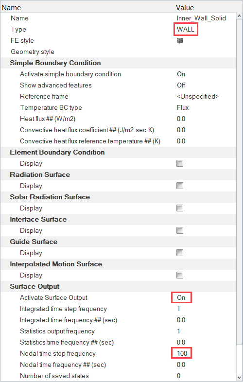

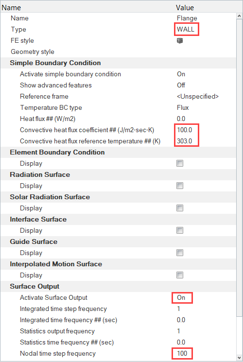

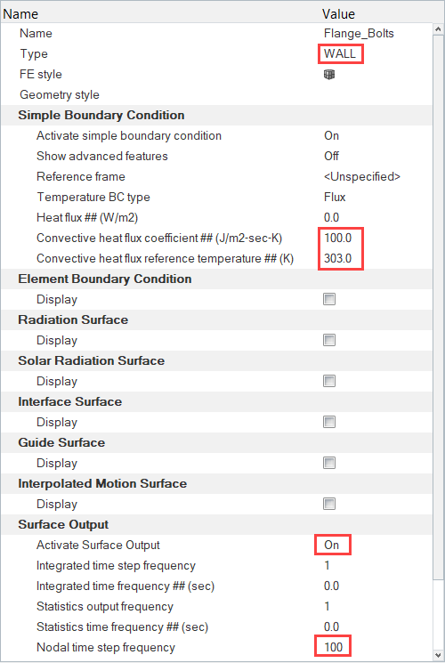

The nodal surface output needs to be activated for all the surfaces in order to create the OptiStruct input deck from the acuOptiStruct command.

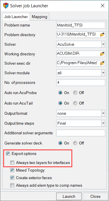

Compute the Solution

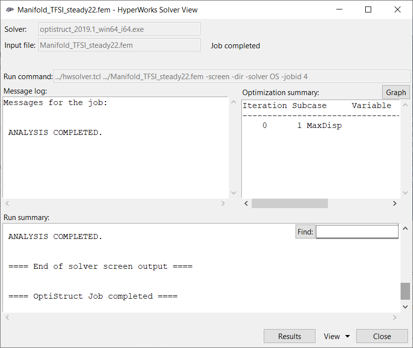

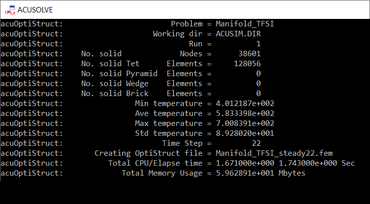

Now that the AcuSolve solution has been calculated, you are ready to use the utility ‘acuOptiStruct’ to generate the OptiStruct input deck and run the case using HyperWorks Solver Run Manager. HyperWorks Solver Run Manager is a simple utility which allows to launch any HW solver by selecting appropriate input file(s) and typing any options (if needed) in the field displayed. OptiStruct is an industry proven, modern structural analysis solver for linear and nonlinear structural problems under static and dynamic loadings. OptiStruct can be started directly from the Start menu.
acuOptiStruct uses the flow and thermal data from an AcuSolve conjugate heat transfer CFD simulation to specify the temperature and pressure loads and generates the files necessary to perform a thermal stress analysis using OptiStruct. Executed after the completion of the AcuSolve simulation, acuOptiStruct writes out the solid element mesh data from the AcuSolve run as well as the convective heat transfer information on the wetted surfaces of the solid mesh. Data is written directly in OptiStruct format, both eliminating data loss due to projecting results from one mesh to another and adding fidelity with spatial variation of temperatures and heat transfer coefficients.
In the next steps, you will execute the acuOptiStruct command with the necessary options, which will generate a .fem file. Then you will use OptiStruct to solve the structural problem.

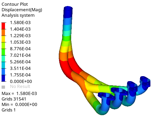

Create a Contour Plot of Displacement and Element Stresses

In this tutorial you learned how to set up a conjugate heat transfer problem using HyperMesh and solve it using AcuSolve. Once you computed the solution, you used acuOptiStruct to generate the input deck for OptiStruct. Once the solution for the structural analysis was computed, you post-processed the results using HyperView and created contour plots of Temperature, Pressure, Displacement and Stress.
