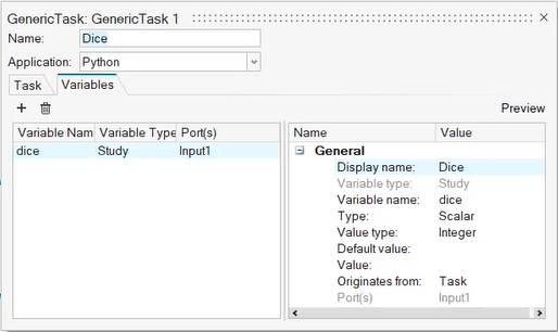

                        The GenericTask dialog opens and a generic task is created in the Block Diagram.
 - In the GenericTask dialog, enter Dice for Name.
 - For Application, select Python.
 - In the Task tab, select Script.
 - For Script language, select Python.
 - For Script name, browse and select the Python script located in the pulse\casino_game\Script folder.
                        In the Variables tab, click
                     - Click the newly created study to populate the Preview.
 - For Display name, enter Dice.
 - For Variable name, enter dice.
 - Verify the Type is set to Scalar and Value type is set to Integer.
                        For Originate from, select Task.
Figure 1. - Close the GenericTask dialog.

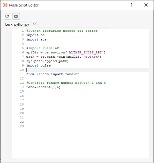

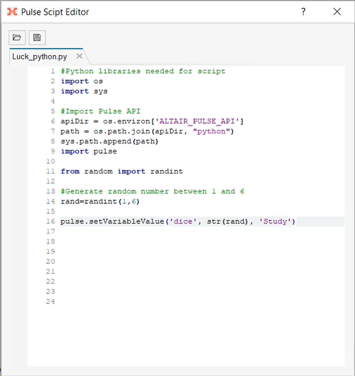

                Link the script to Pulse using script editor.
                        In the Block Diagram, right-click the generic task and select
                                Edit Script from the context menu.
                        The Pulse Script Editor dialog opens and displays the Python script.
                        Before the Python script, enter the following Process API
                            Command:
#Import Pulse API apidir = os.environ['ALTAIR_PULSE_API'] path = os.path.join(apidir,"python") sys.path.append(path) import pulse
Figure 2.Note: Learn more about Process API Commands. - After the Python script, enter the pulse.setVariableValue command.
                        Enter the following inputs:
- Name of the Pulse variable: 'dice'
 - The value it's going to take: str(rand)
 - Type: 'Study'
Figure 3.The command should read aspulse.setVariableValue ('dice', str(rand), 'Study'). -
                        Click
 and save the updated
                            script.
                        Close the Pulse Script Editor dialog.
                        The
setVariableValuecommand gives the dice variable the value of the random number generated by randint.

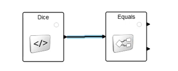

                        In the Block Diagram, connect the output port of Dice to the input port
                            of Equals.
Figure 4. -

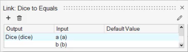

                        Right-click the connection and select Edit from
                            the context menu.
                        The Link dialog opens.
                        In the Link dialog, Output column, select
                                Dice (dice) for a (a) input.
Figure 5. - Close the Link dialog.

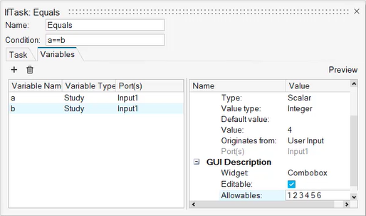

                Modify Widget.
                        In the Block Diagram, right-click the Equals
                            task and select Edit from the context menu.
                        The If Task dialog opens.
 - In the Variables tab of the If Task dialog, select the b variable.
 - In the GUI Description, select Combobox for Widget.
                        For Allowables, enter 1 2 3 4 5 6.
Figure 6. - Close the If Task dialog.

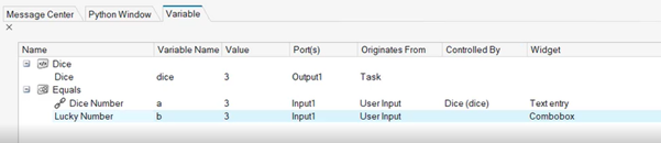

                Change variable display names.
- In the Variable Browser, enter Dice Number as the new name of the a variable.
 - For the b variable, change the name to Lucky Number.
Figure 7. -

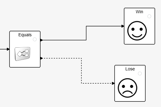

- From the Tasks folder inside the Library, drag-and-drop the Win and Lose tasks into the work area.
 - In the Block Diagram, connect the output ports of Equals to the input ports of Win and Lose.
Figure 8. -

                        The Equals dialog opens.
 - In the Equals dialog, select a number for Lucky Number.
 - Click Proceed.
The values are updated in the Variable Browser. -
