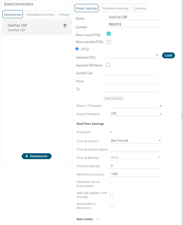

1. Select OneTick CEP from the Connectors panel. The OneTick CEP Settings panel displays.
2. Enter the Name of the OneTick
CEP data source, then click
3. Enter the Context (for example, REMOTE).
4. You can either check:
· Show Local OTQs box to display the local OTQs in the Selected OTQs drop-down list.
· Show Remote OTQs box to display the remote OTQs in the Selected OTQs drop-down list.
5. Click Load
to
populate the Selected OTQ
drop-down list. Select an OTQ.
The OTQ Parameters section displays with the list of input parameters based on the selected OTQ.
6. Check/uncheck the Separate DB Name box.
7. Click
to populate the Id Column
list box.
From this list box, select the field which will define a unique data record to subscribe against.
The following are generic to all OTQs:
· Symbol List
· From
· To
These add additional filter criteria such as symbol, and time window onto the basic OTQ.
8. Date/Time values of output data and Date/Time inputs, where supported, is by default unchanged.
9. For this section:
Refer to Define Real-Time Settings for more information.
10. Set the row limit of the data set.
11. Tap the Preview Selected Data Source slider to turn it on.
12. Click
to display the data preview.
