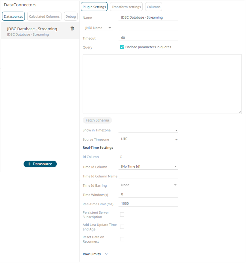

1. Select JDBC Database - Streaming from the Connectors panel. The JDBC Database - Streaming panel displays.
2. Enter the Name of the JDBC Database
- Streaming data source, then click
3. You can either select:
· JNDI Name

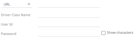

· URL
Enter the URL specific to the database’s JDBC driver, the Driver Class Name specific to the driver, and the User Id and Password.
Check the Show Characters box to display the entered characters.
4. Enter the Timeout or the length of time to wait for the server response. Default is 60.
5. Enter the Query, which can contain parameters in a similar manner to the database connector.
6. Select whether the parameters should be automatically enclosed in quotes, by checking the Enclose parameters in quotes box.
7. Click
to retrieve the schema
of the configured subscription.
This also populates the Id Column with the set of columns, of arbitrary type, that can be concatenated to form a unique row identifier.
8. Date/Time values of output data and Date/Time inputs, where supported, is by default unchanged.
9. For this section:
Refer to Define Real-Time Settings for more information.
10. Set the row limit of the data set.
11. Tap the Preview Selected Data Source slider to turn it on.
12. Click
to display the data preview.
