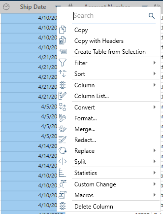

Right-click on a table or click on the down-arrow beside a column:
to display a list of Prep Data operations available for that column's data type:
Select an operation.
Note that for some operations, a dialog box will display asking for additional information.
To quickly locate an operation you wish to apply to the selected column, search for it using the Search bar provided.
