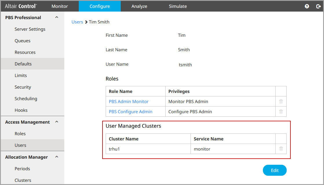

User Managed HPC Clusters
Figure 1. User Managed HPC Cluster

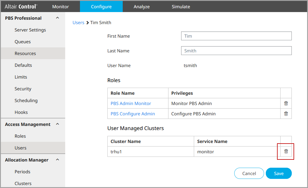

Revoking Access to a User Managed HPC Cluster
Figure 2. Revoke Access to a User Managed HPC Cluster

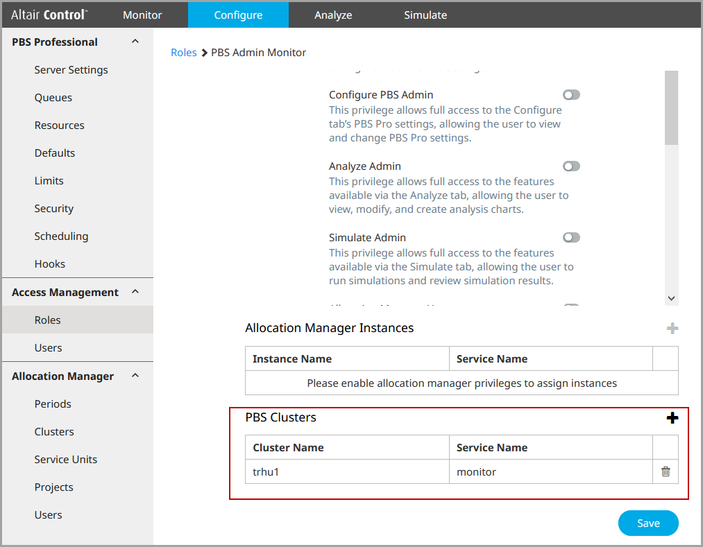

Permit or Restrict Access to an HPC Cluster
Figure 3. Permit or Restrict Access to an HPC Cluster

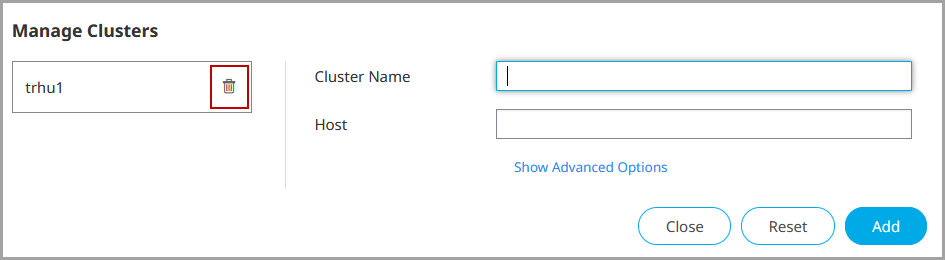

Removing an HPC Cluster
- users assigned to the Manager role.
- the user who added the HPC cluster.
- in the case where the cluster was added via the Monitor tab, any user who is assigned a role with Monitor PBS Admin privileges that has been granted access to the HPC cluster by a Manager.
Figure 4. HPC Cluster Removal
