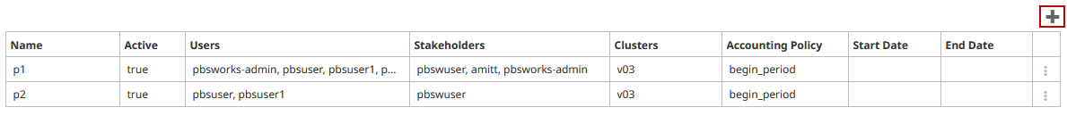

- Click the Configure tab.
- Click Projects from the Budget Manager menu located on the left-hand side of the web page.
Click
Figure 1. Add a Project Account -
