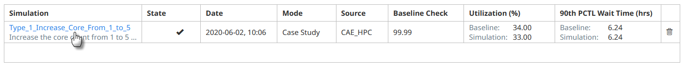

Simulation List
Any simulations that are running or complete are available for viewing via the Simulation list. The Simulation list provides a summary for each simulation containing the following information:
- Simulation
- Simulation name and description.
- State
- Denotes the status of the simulation.
- A progress bar indicates the simulation is running.
- A spinner
indicates that simulation is being analyzed.
indicates that the simulation is complete.
indicates that the simulation has been killed or has
failed.
- Date
- Date and time that simulations is started.
- Mode
- Type of simulation. Currently, only a manual simulation (case study) is available.
- Source
- Name of the snapshot used for the simulation.
- Baseline Check
- A fitness metric that compares the baseline simulation analysis results to the historical data analysis results. Scores closer to 100 indicate that the simulated behavior of your HPC cluster is similar to the behavior of your actual HPC cluster.
- Utilization
- Percentage of core utilization indicates how efficiently the HPC's CPUs are being utilized. A score for both the simulation and the baseline simulation are displayed for comparison.
- 90th PCTL Wait Time
- The 90th percentile of wait time indicates the value for which 90% of the job waittimes are smaller and 10% are bigger. A score for both the simulation and the baseline simulation are displayed for comparison.

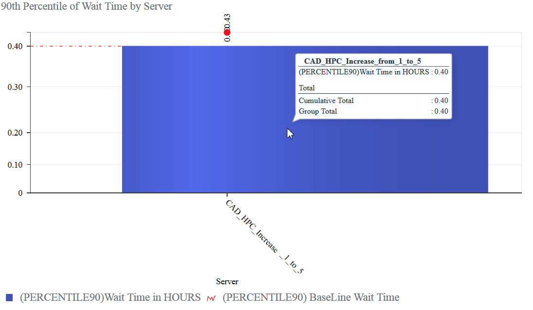

90th Percentile Waittime
The 90th percentile of waittime indicates the value for which 90% of the job waittimes are smaller and 10% are bigger. Statistically, to calculate the 90th percentile value:
- Sort the job waitimes in numerical order.
- Remove the top 10% instances.
- The highest value left is the 90th percentile.
The results of the simulation in the example below shows the 90th percentile of waittime is .40 hours as compared to the baseline of .43 hours. Therefore, 90% of jobs had a waittime less than or equal to .40 hours and 10% of jobs had a waittime greater than .40 hours. A slight decrease in the 90% percentile value occurred based on the simulation's proposed HPC configuration changes.
Figure 1. 90th Percentile Waittime

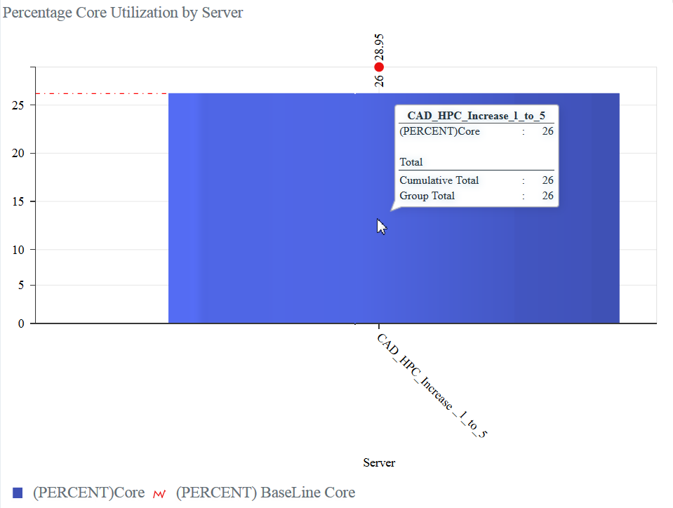

Percentage Core Utilization
The percentage core utilization indicates how efficiently the HPC's CPUs are being utilized. In the below example, the proposed changes to the HPC had a slight negative impact on core utilization, decreasing it from 28.95% to 26%.
Figure 2. Percentage Core Utilization
