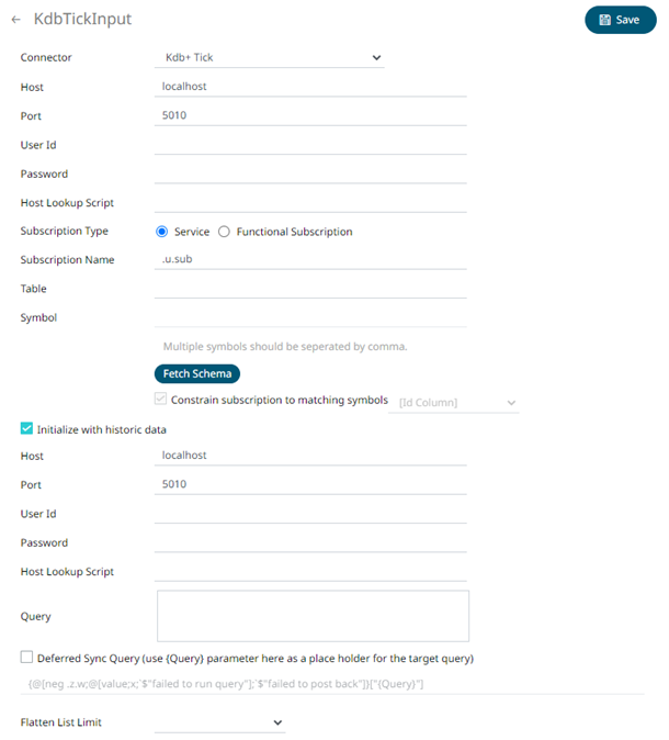

The Kx kdb+tick input data source allows connection to a Kx kdb+ ticker plant on a real-time streaming basis.
Specifically, it allows Panopticon Streams to subscribe to Kx kdb+tick through the definition of Service, Table, Symbol, or directly through Functional Subscription.
1.     In the New Data Source page, select Input > KDB+ Tick in the Connector drop-down list.
2.     Enter the following properties:
Property
Host
Kx kdb+tick host address.
Port
Kx kdb+tick host port. Default is 5010.
User Id
The user Id that will be used to connect to Kx kdb+tick.
Password
The password that will be used to connect to Kx kdb+tick.
Host Lookup Script
Key of the authentication script setting that will be searched in the connector.host.lookup.scripts property in the Streams.properties file.
The authentication script setting will issue a shell script call passing a JSON structure containing host, port, username, and password (as below).
{ "host": "host",
"port": 5001,
"username": "username",
"password": "password"}
NOTES:
·         The port should be a number and has no double quotes. This is done to avoid unwanted casts.
·         Only host and port are mandatory.
Calling the script in-process from the Tomcat server running Panopticon allows automatic pick-up of the Kerberos token of the system account that started the Tomcat process.
NOTE:
An exception will be thrown if the key used in the connector is not configured in the Streams.properties file.
   NOTE
These properties can be parameterized.
3.     Select either Subscription Type:
·         Service
¨        Subscription Name (e.g., .u.sub)
   NOTE
Instead of entering the table and symbol to subscribe against in the Table and Symbol text boxes, you can specify the full subscription syntax in the Subscription Name text box. For example:
.u.sub[`table;`symbol]
To subscribe to the trade table and AAPL, AIG, and DOW symbols, enter this in the Subscription Name text box:
.u.sub[`trade;`AAPL`AIG`DOW]
¨        Table to subscribe against (e.g., trade)
   NOTE
•      You may use just a back tick for the table name, intending to subscribe to all available tables.
•      When a table name is not entered in the Table text box, then the Symbol text box is disabled meaning it will not be used while doing subscription.
¨        Symbol to subscribe against (e.g., AAPL)
   NOTE
Multiple symbols should be separated by a comma.
·         Functional Subscription
Enter the functional subscription that needs to be issued (e.g., .u.sub[`trade;`])
4.     Click  to retrieve the schema of the configured subscription.
This populates the Id Column with the set of columns from the schema of type sym and the text array such as Character/Boolean/GUID, etc.
5.     Check Constrain subscription to matching symbols to select the column which contains specific symbols. Otherwise, the filtering against these symbols will not take place.
   NOTE
The Constrain subscription to matching symbols only lists sym fields. Therefore, if you select a non sym type in the Id Column, it is not recommended to select the default value [Id Column] in the Constrain subscription to matching symbols drop-down list.
6.     Activate or deactivate Initialize with historic data. If unchecked, the data source will only be populated with streaming updates that are subscribed against. If checked, the data source is first initialized against a store of data, after which subscribed streaming updates are then applied.
7.     Enter the following information:
·         Host
·         Port
·         User Id
·         Password
·         Host Lookup Script
·         Query
These entries can be parameterized.
8.     Check Deferred Sync Query box to allow the Kxkdb+tick data source to support synchronous and asynchronous reads. The advantage of using this option is that there is no queue on the Kx kdb+tick server side, queries are farmed out to slaves and returned to asynchronous instead.
The {Query} parameter is used as a place holder for the target query that is defined in the Query builder.
9.     Select the Flatten List Limit.
This allows retrieval of the first ‘n’ items in the list and produce new columns in the output schema with a dot notation.
For example, if there are two nested fields (BidPrices and OfferPrices) and the flatten list limit selected is five, then the output schema will be:
BidPrices.1, BidPrices.2, BidPrices.3, BidPrices.4, BidPrices.5, OfferPrices.1, OfferPrices.2, OfferPrices.3, OfferPrices.4, OfferPrices.5
If there are less than five items in the list, then the values will be null.
   NOTE
Currently, this feature works for the Service subscription type. Also, it only flattens numeric columns.

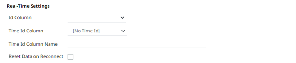

10.   Select the ID Column.
This defines the column that uniquely identifies a row in the returned stream, and is used for processing inserts, updates and deletes.
This allows the latest update time and its age to be highlighted by the defined color range in the output dashboard.
Furthermore, a streaming time series window can be generated by creating a compound key with the Id Column, plus a separately specified Time ID column.  This Time ID column can be from the source dataset, or alternatively automatically generated.
If the Time Id column is selected, then a scrolling time window can be specified.
For Automatic Time Id, define the Time Id Column Name.
As new data arrives from the subscription new time slices will automatically be added, and old ones will be deleted.
11.   Check the Reset Data on Reconnect box to flush out the stale data and reload data after reconnection.
