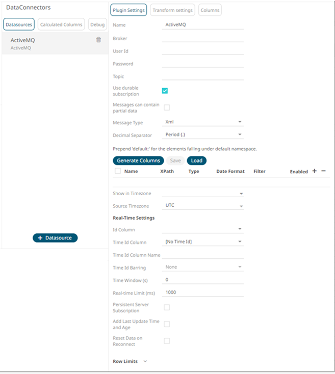

1. Select ActiveMQ from the Data Sources pane. The ActiveMQ Settings pane and the retrieved ActiveMQ source are displayed.
2. Enter the Name of the ActiveMQ
data source, then click
3. Enter the following information:
Property |
Description |
Broker |
The location of the message broker. |
User Id |
The user Id that will be used to connect to the ActiveMQ service. |
Password |
The password to connect to the ActiveMQ service. |
Topic |
The topic or queue physical name. |
4. Check/uncheck the Use durable subscription box.
NOTE |
When connecting to a message bus, it is recommended to disable durable messaging. When it is enabled, this puts a heavier load to the server, and slows down the start and stop of subscriptions.
5. Check/uncheck Messages can contain partial data box.
6. Select the Message Type.
7. Select either the dot (.) or comma (,) as the Decimal Separator.
NOTE |
Prepend 'default:' for the elements falling under default namespace.
8. Click
to the fetch the schema based
on the connection details. Consequently, the list of columns with
the data type found from inspecting the first ‘n’ rows of the input
data source is populated and the Save button is enabled.

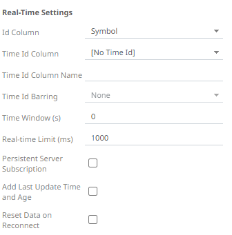

12. For this section:
Refer to Define Real-Time Settings for more information.
