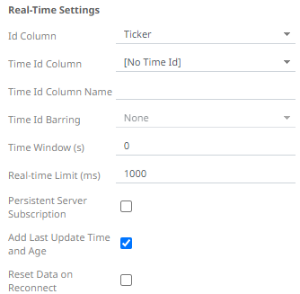

Streaming connectors have a common section for defining real-time settings. Follow the steps below to select a key column or create a compound key for the streaming time series window.

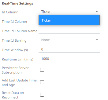

1. On the expanded Real-Time Settings section, if the Type is set as Text, it will be listed in the Id Column drop-down list box and can be used to select a key column to manage data updates and inserts.
NOTE |
Every message definition needs a text column to be defined as the Id column. By default, only the latest data will be loaded into memory.
2. You may opt to check the Add Last Update Time and Age box. Note: This is only available when No Time ID has been set.
This allows the latest update time and its age to be highlighted by the defined color range in the output dashboard. Refer to Highlighting the Latest Data in Real Time Streaming Connectors for more information.

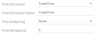

3. A streaming time series window can be generated by creating a compound key with the Id Column, plus a separately specified Time Id column. The Time Id column can be from the source dataset, or alternatively automatically generated.
If the Time Id column is selected, then a scrolling time window can be specified. As new data arrives from the subscription, new time slices will automatically be added, and old ones will be deleted.

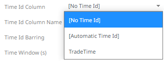

Select either:

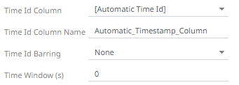

· Automatic Time Id
· Date/Time Id column either from the source data or automatically generated

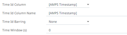

For the AMPS connector, there is also the AMPS Timestamp Time Id column.
This means that when a message arrives, AMPS calculates its expiration time and stores a timestamp at which the message expires in the SOW.

· Time Id Column Name for Automatic Time Id
