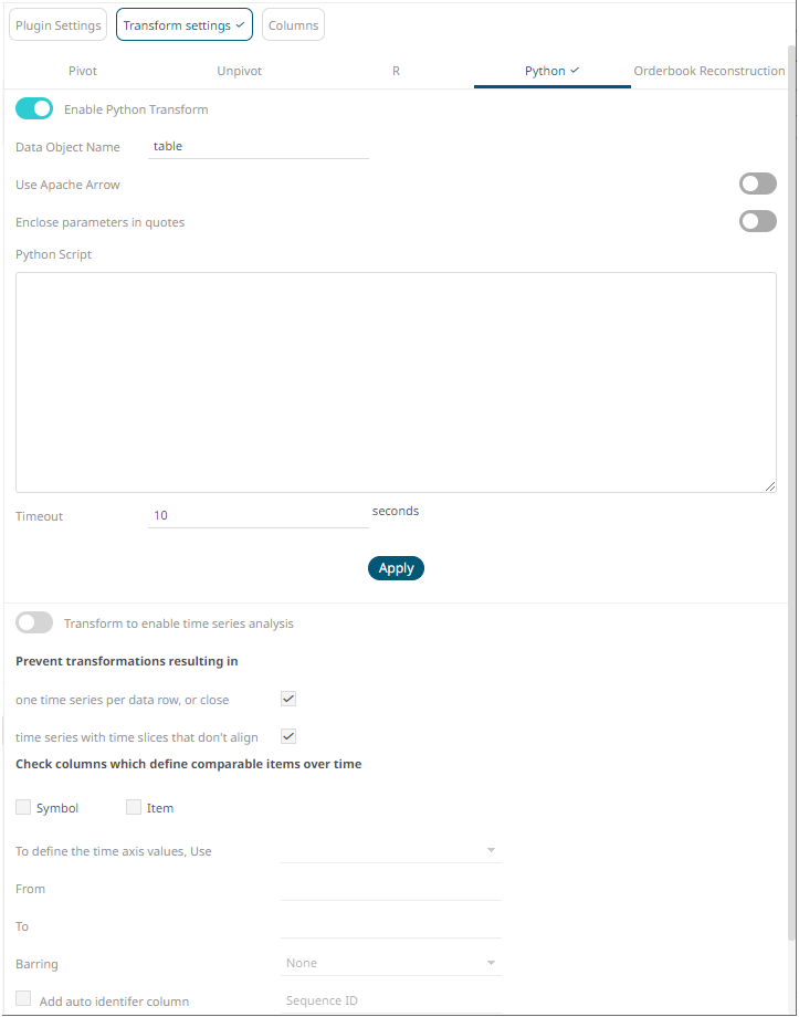

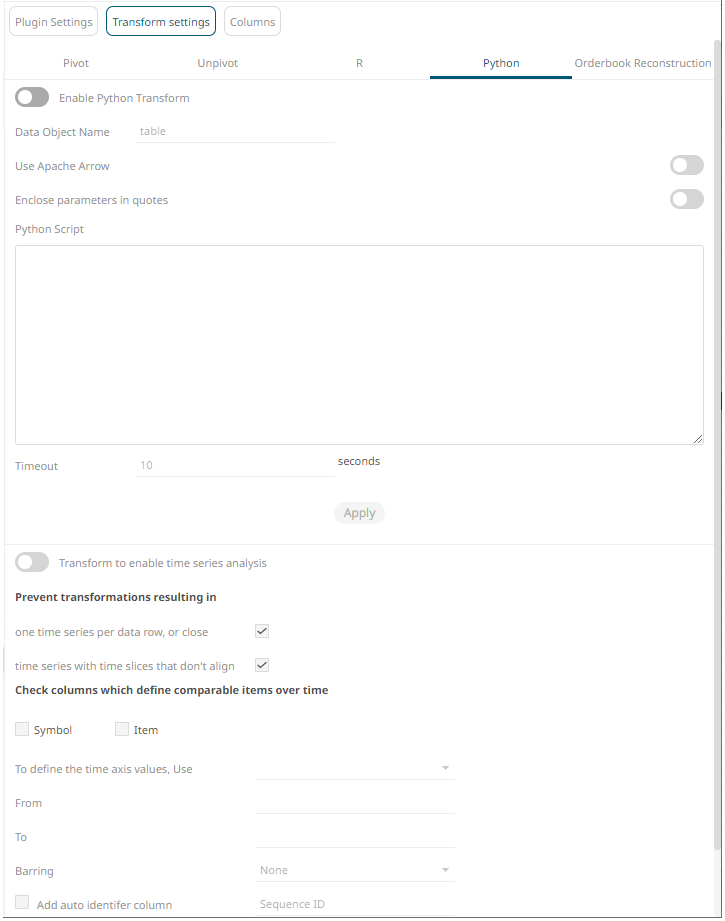

When the Python button is selected, the dialog changes to show:
1. Tap the Enable Python Transform slider.
The
Transform Settings button and Python tab change to
and
respectively.
2. Specify the Host and Port of the Pyro process, along with the HMAC key (Password).
3. Specify the Data Object Name. This defines the data structure (list of dictionaries) that Panopticon Visualization Server will produce, and then will be utilized by the Python script.
4. Select the Serialization Type: Serpent or Pickle
· Serpent – simple serialization library based on ast.literal_eval
· Pickle – faster serialization but less secure
Modify the configuration.py file located in ..\Anaconda3\Lib\site-packages\Pyro4 to specify the serialization to be used.
For example, if Pickle is selected, self.SERIALIZER value should be changed to pickle and self.SERIALIZERS_ACCEPTED value should be changed to include pickle:

6. Enter the Python Script or load from an associated file (selected by clicking the Browse button). This returns the output list of dictionaries. Just like an underlying SQL query, the Python script itself can be parameterized.
