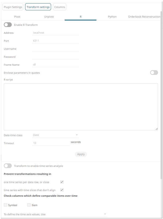

When the R button is selected, the Transform Settings pane changes to show:

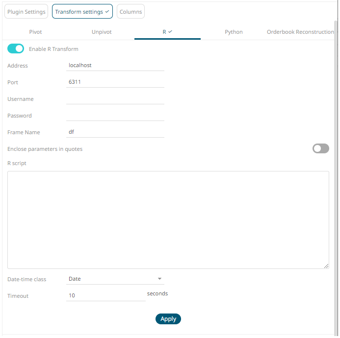

1. Tap the Enable R Transform slider to turn it on.
The
Transform Settings button and R tab change to
and
, respectively.
The default Address (i.e., localhost) and Port (i.e., 6311) fields are displayed.
2. Specify the Username and Password if authentication is enabled on the Rserve process.
NOTE |
The Address, Port, Username, and Password fields will be hidden if their corresponding properties are set in the Panopticon.properties file.
3. The Frame Name that Panopticon will produce, and then be utilized by the R scripts should be specified. Default is df.
4. Enter the R Script. This R script should reference the input frame name and return a data frame. Just like an underlying SQL query, the R Script itself can be parameterized.
NOTE |
This step will work for small and simple use cases. However, when you have several transforms, or when each transform is applied to several data tables, it is highly recommended to follow the instructions in the Best Practices on Working with R Transform in Panopticon section.
5. Select the Date-time class that will be applied to the transform:
· Date is the simplest data type to use for calendar dates. It is stored as integers and is represented as the number of days since 1970-01-01, with negative values for earlier dates.
· chron that can be used for chronological objects which can handle dates and times.
· POSIXct is built-in POSIXt date-time data type with ct that stands for calendar time. It stores the number of seconds since the origin.
6. Specify whether to Enclose Parameter in Quotes.
7. The Timeout is set to 10 seconds by default to ensure that slow running R scripts do not impact other areas of the product. You can opt to enter a new value.
