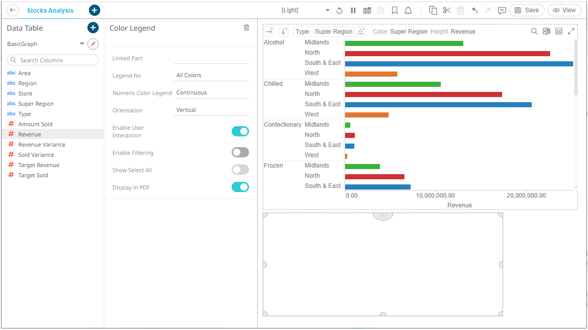

1. After double-clicking or drawing a rectangle
on the dashboard canvas, click
on the Select Part pane
then click the Color Legend
icon.
The Color Legend Settings pane is displayed, and the Color Legend part is added on the dashboard canvas.

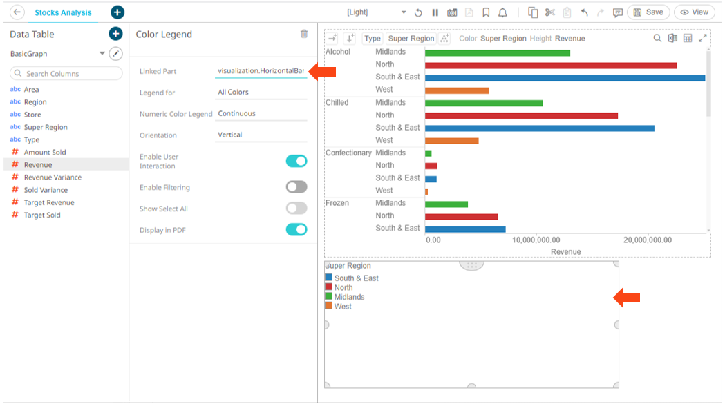

2. Select from any of the available parent visualizations with color variable from the Linked Part drop-down list.
The color legend is now connected to its parent visualization. It will retrieve color variables from this visualization and display them in the legend on the dashboard.

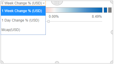

If the visualization can display multiple color variables, which is the case with the Table and Timeseries Combination, then the legend displays a drop list of possible variables to display.

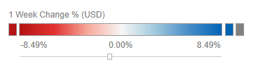

The numeric style color legend displays the color range used within the associated visualization for the selected numeric source column.

6. Tap the Enable User Interaction slider to turn it on and display the numeric color range slider.
Otherwise, the color legend is read-only and the slider is hidden:
