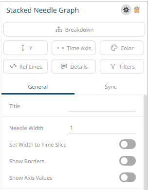

Stacked Needle Graph Settings
The stacked
needle graph settings pane is displayed after clicking the Settings
icon
or the Visualization Title (i.e., Stacked Needle Graph):
Setting |
Description |
Needle Width |
Specifies the width in pixels for each needle: |
Set Needle Width to Time Slice |
Determines whether the Needle width will be extended to the width of the time slice. NOTE: Will not go past a null/empty time slice. |
Show Borders |
Determines whether borders are drawn around needles. These are only visible if the Needle Width is greater than 1 pixel. |
Show Axis Values |
Determines whether the graph coordinates (i.e., X-Y plots, or Date/Time-Y plots) on mouse over are displayed in the visualization. |

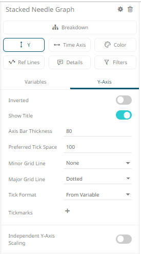

Other visualization-specific properties can be set by clicking on the Y-Axis variable drop area and then selecting the Y-Axis tab:
Setting |
Description |
Independent Y-Axis Scaling |
Determines whether to have each visualization Y-axis in a cross tab automatically scaled independent of the others. |
