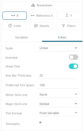

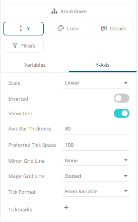

Some visualizations may also include the following X and Y axes settings:
Setting |
Description |
Scale |
Determines whether the scale of the axis is Linear, Log, or Power. · Linear – a change between two values is based on addition e.g., 30, 60, 90, 120, 180, etc. · Log - a change between two values is perceived on the basis of the ratio of the two values or based on multiplication. Once selected, the Base control displays with the value of the common base for the logarithmic scale (i.e., 10).
For example: log10(x) represents the logarithm of x to the base 10 e.g., 1, 10, 100, 1000, etc. You can opt to enter a new Base
value then click NOTE: Value cannot be lower than 2. · Power – Works according to the SIGN(MEASURE)*LOG10(MAX(1, ABS(MEASURE))) formula. Works like the Log scale except it can handle negative values and every value between -1 and 1 is set to 0. For example, for values between -100 and 100, the axis will be: -100, -10, 0, 10, 100 |
Inverted |
Determines whether the Y or Height axis (for Vertical) or X or Width axis (for Horizontal) is inverted. |
Show Title |
Displays an Axis Title label. |
Axis Bar Thickness |
The margin in pixels for the axis. If set to zero, the axis is removed. |
Preferred Tick Space |
The preferred space in pixels between the minor grid lines across the axis. |
Minor Grid Line |
How minor grid lines are drawn across the axis. Allowed values: None · Dotted · Dashed · Solid |
Major Grid Line |
How major grid lines are drawn across the axis. Allowed values: · None · Dotted · Dashed · Solid |
Tick Format |
Set to From Variable to use the format string that is on the current variable displayed in the axis. Set to Metric Prefix to format the Tick labels in the numeric axes using the metric prefixes. |
Tickmarks |
Click
Enter the Value and the Label. Click
to
add and set tick marks.
to delete.
