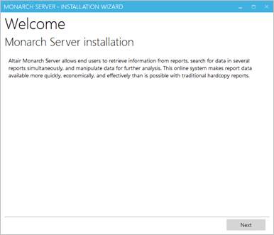

1.     In the directory with installation files, double-click MonarchServerInstaller.exe to launch the Monarch Server Installation Wizard.
Click  Next.
