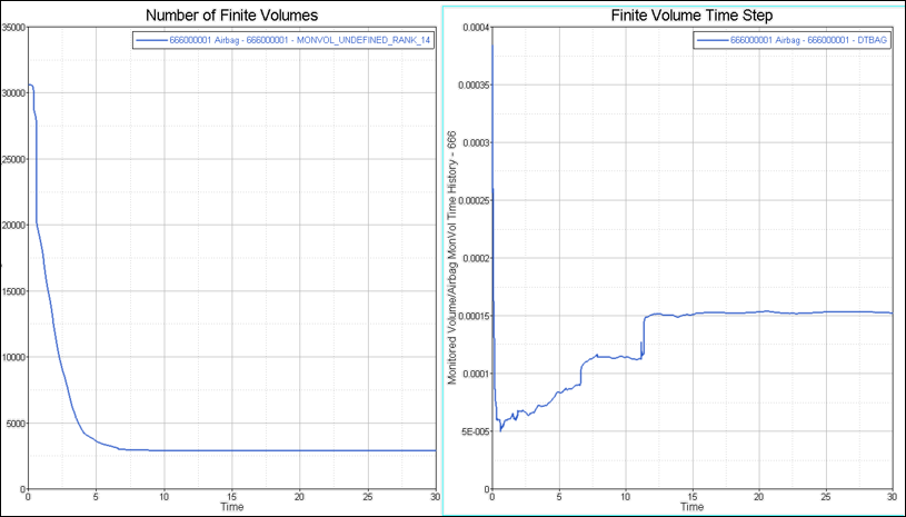

1 0.010 0.001 1Variation of time step scaling coefficient and global merging parameter may be necessary to provide proper time step and number of FV at the end of the simulation.
The number of finite volumes should reduce smoothly to 2-10% of initial number of finite elements. The merging strategy should also provide a time step higher than the minimal time step required in crash simulations.

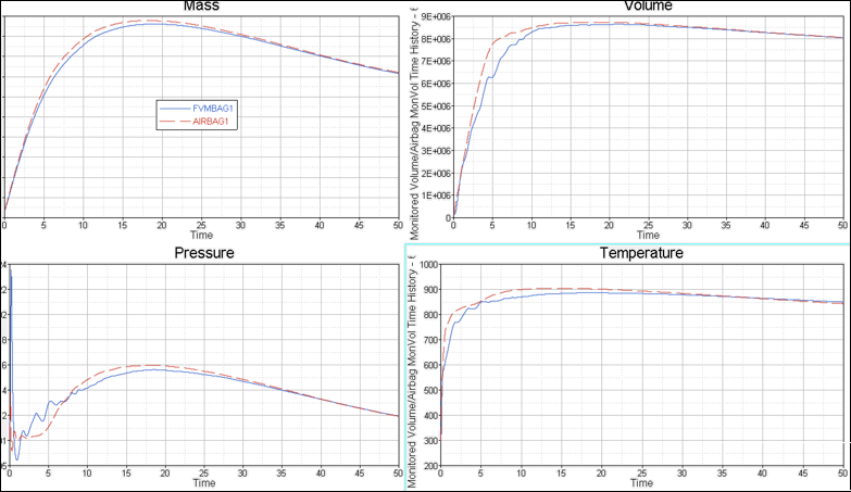

Figure 2. Comparison of Airbag Output for AIRBAG1 and FVMBAG1 Simulations

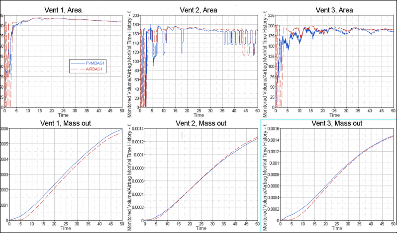

Figure 3. Comparison of Venting Parameters for AIRBAG1 and FVMBAG1 Simulations
The vent area and vent outflow should be plotted for each vent and controlled and compared to uniform pressure run.
