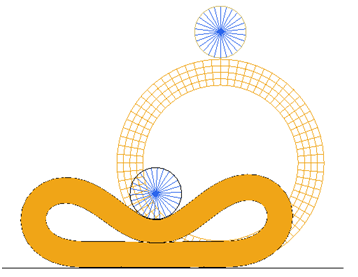

Model Description
The purpose of this example is to demonstrate a nonlinear large displacement implicit analysis involving hyper-elastic material and contacts using Radioss.

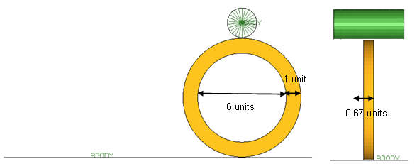

Figure 2. Geometry of the Rubber Ring and Roller Model
- Material Properties
- 0.7
- -0.5
- 2.0
- 2.0
- Poisson's ratio
- 0.495
- Density
- 7.9e-9
- Young's modulus
- 600
- Poisson's ratio
- 0.3

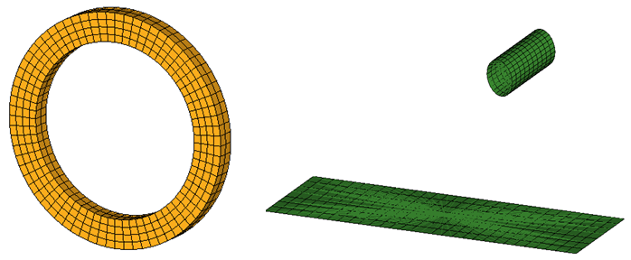

- Mesh and propertiesThe ring mesh is a regular solid mesh modeled with four elements (dimension of 0.25 units) along the width and two elements (dimension of 0.335 units) through the thickness. The flat rigid surface and the circular roller are both modeled as a regular shell mesh of 0.01mm thickness with the flat surface around 0.75 units in dimension and the roller being around 0.467 units in dimension.

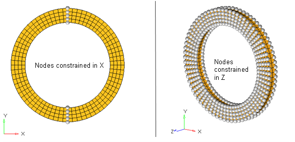

Figure 3. Geometry of the Rubber Ring and Roller ModelThe ring has been modeled using first order fully-integrated solid elements./PROP/SOLID/5 WHEEL 14 10 1 222The flat surface and roller have been modeled using the first order reduced integration shell elements with three integration points through the thickness. Full integration elements were not considered as you are not interested in any detailed post-processing of the barrier./PROP/SHELL/6 BARRIER 1 2 3 0.01 - Load and boundary conditionsThe boundary conditions applied to the rubber ring in step 1 are shown in Figure 4.

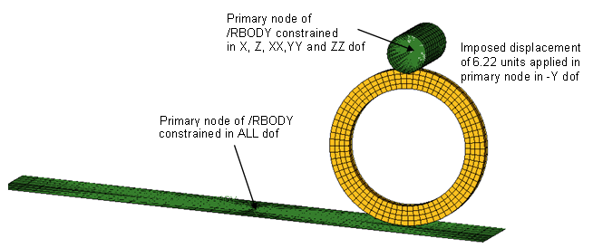

Figure 4. Boundary Conditions Applied to Ring in First StepThe boundary conditions applied to the flat rigid surface and circular roller in step 1, are shown in Figure 5.

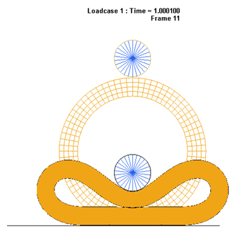

The flat surface is constrained in all DOF's, while the roller is pushed down by 6.22 units in Y-axis so much that self-contact is established within the inner surface of the ring.

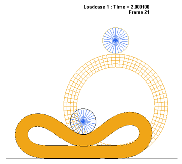

Figure 5. Boundary Conditions Applied to Flat Surface and Roller in 1st StepIn the second step, the top roller is to be simultaneously translated and rotated such that the wheel in the crushed configuration rolls along the flat rigid surface in -X direction. So, the X translation and ZZ rotations of the circular roller have to be released from the primary node of /RBODY. Additionally, the center nodes of the ring that were constrained in X DOF (Figure 4) need to be released for the ring to roll along the flat surface. So, the Engine file for the second step has the following cards representing release of the above-mentioned degrees of freedom./BCSR/TRA/X/ 5 6 8 9 15 16 17 18 87 88 89 93 94 95 241 242 243 244 245 246 5717 5699 5681 5663 5662 5537 5517 5497 5477 5476 2269 /BCSR/ROT/Z 2269 - Contact definition

Figure 6. Deformed Shape of the Rubber Ring After 1st Step
Figure 7. Deformed Shape of the Rubber Ring After 2nd Step

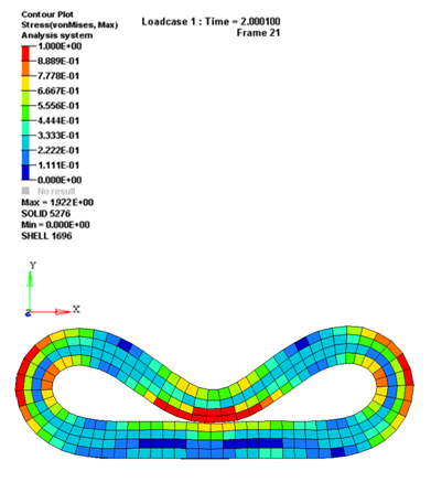

Figure 8. Stress in the Rubber Ring
