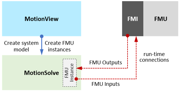

- The Functional Mock-Up Interface
Functional Mock-up Interface (FMI) is a tool independent standard to support models using a combination of xml-files and compiled C-code.
The FMI defines an interface to be implemented by an executable called an FMU. The functions in the FMI are used by MotionView to create one or more instances of the FMU in MotionSolve. The FMU in MotionSolve is a generic entity that is described by a set of differential and algebraic equations. At run-time, when MotionSolve needs to evaluate these equations or their partial derivatives, the FMU instance in MotionSolve talks to the FMU object through functions that are defined in the FMI. These functions “get” the required values from MotionSolve as input, and “return” the required values from the FMU and as output to MotionSolve. This is illustrated in the figure below.
Figure 1. The interaction between MotionView, MotionSolve and an FMUTwo versions of the FMI, FMI 1.0 and FMI 2.0, are used today. MotionSolve supports only FMI 2.0.

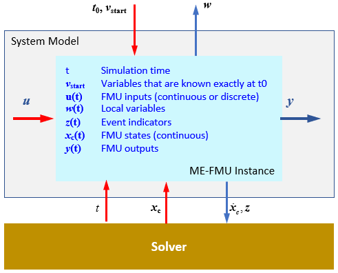

- Model Exchange FMU (ME-FMU)
This type of FMU only defines the equations and other quantities typically needed for a function evaluation. It does not compute the response of the FMU. Instead, the equations of the FMU are incorporated into the solution scheme of MotionSolve and MotionSolve will simultaneously compute the time history of the evolution of the FMU as the simulation progresses. This is a fully coupled solution. The FMU may contain any combination of ordinary differential equations, algebraic equations, and discrete difference equations. MotionSolve can handle all three types of equations.
The structure of an ME-FMU and how it is included in a system model is shown below.- A system model is being simulated. This is shown as a grey box.
- The system model talks to a solver that computes the response of the model to the inputs that are provided. The solver is shown as a yellow box.
- One or more FMUs are included in the system model. This is shown as a blue box inside the grey box.
- The system model does the following:
- In the very first call, it obtains the user-specified start time t0 and user-specified list of variables known exactly at t0, vstart.
- Obtains the current simulation time t and the FMU continuous states xc from the solver (at t0 the solver just returns the initial value provided by the FMU).
- Computes the state dependent inputs, u.
- Given the above input, the FMU does the following:
- Computes the local variables it needs, w.
- Computes the event indicators, z.
- Computes its outputs, y, and returns it to the system model.

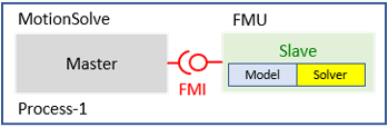

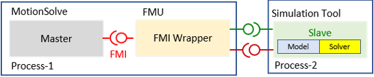

Figure 2. FMU Structure - Co-Simulation FMU (CS-FMU)FMI for Co-Simulation is designed for coupling with subsystem models, which have been exported by their simulators. The FMI is available as follows:
- The FMU solver is embedded in the FMU.
- The FMI is just a wrapper that knows how to talk to an external solver.
Figure 3. Co-Simulation with generated code

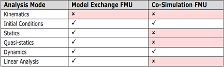

- FMU analysis support in MotionSolve
The MotionSolve analysis support for FMUs depend on the type of the FMU. The analysis support is summarized in the table below. Analysis modes that are not supported are shaded in salmon color.
