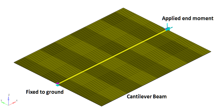

The cantilever beam is modeled using 250 NLFE BEAM elements in MotionSolve. The left end of cantilever beam is fixed to the ground by a fixed joint. The right end has a planar joint with ground (this is to minimize numerical instability and aid in the simulation. This does not affect the physics). Gravity is turned off for this model. The moment is applied at the right end of the beam.
Figure 2. The Cantilever Beam Modeled in MotionView

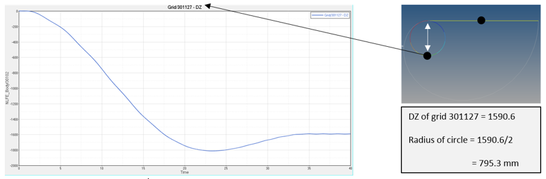

The actual radius of the deformed beam can be determined by calculating the Z displacement of the node at the midpoint of the beam and dividing the value by 2.

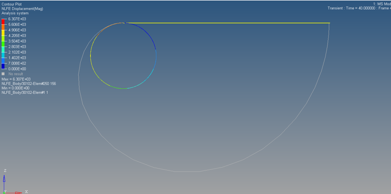

Figure 3 below depicts the deformation of the cantilever beam under the end moment load. Tracing is turned on so the deformation of the beam can be visualized. The yellow component represents the undeformed shape and the component with contours represents the final deformed shape at the end of the simulation. The trace of last element of the beam (grey) can also be visualized as it deforms during the simulation. As can be seen, there is a large rotation of this element from the undeformed to the final deformed state.
Figure 3. Magnitude of Displacement for the Endpoint Node
To determine the radius of the deformed shape, you can plot the Z displacements of GRID/301127 (the mid-point of the beam) from the MRF file and divide the value by 2.
Figure 4. Z displacement for GRID/301127
