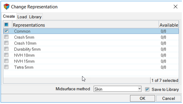

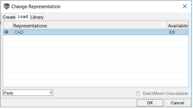

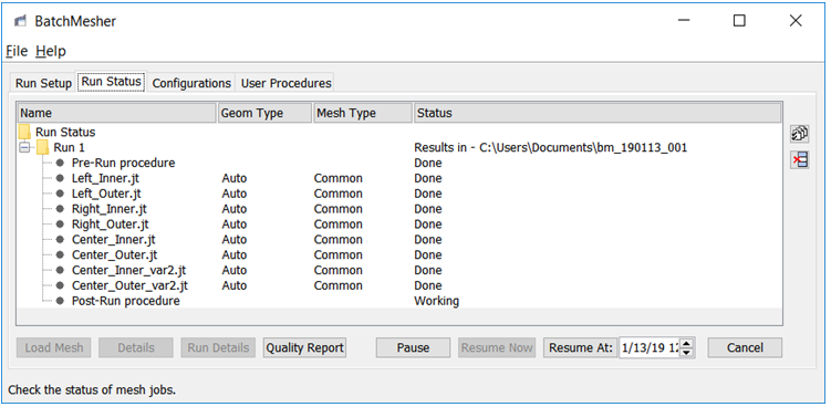

Load and Create a Common Representation
In this step you will load and create a common representation.
Steps 3.4 - 3.6 below are optional as the Common representation can be created without loading the CAD into the session. Since the Common representation forms the basis of subsequent discipline specific mesh representations, its creation is a prerequisite for the next steps.

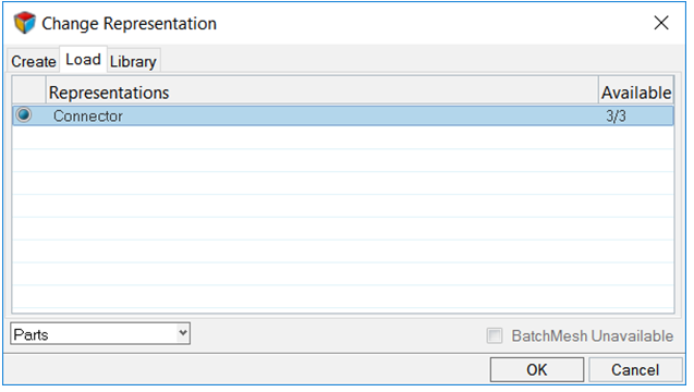

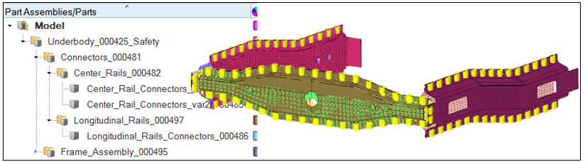

Add Connector Representations
In this step you will add connector representations.

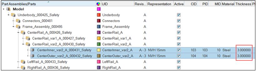

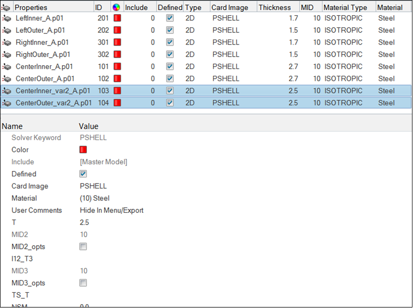

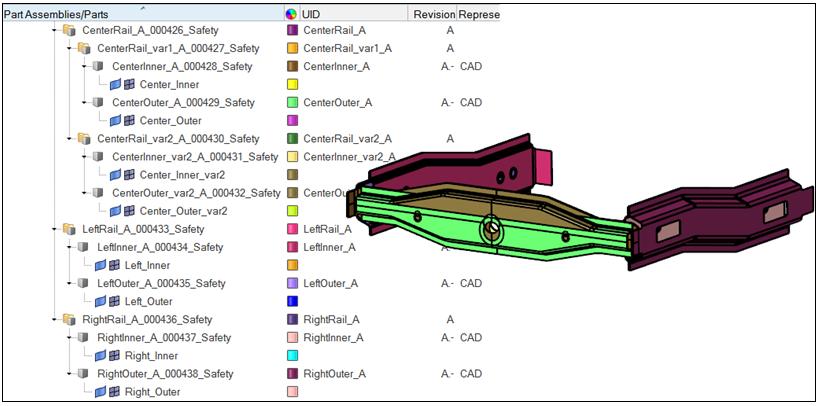

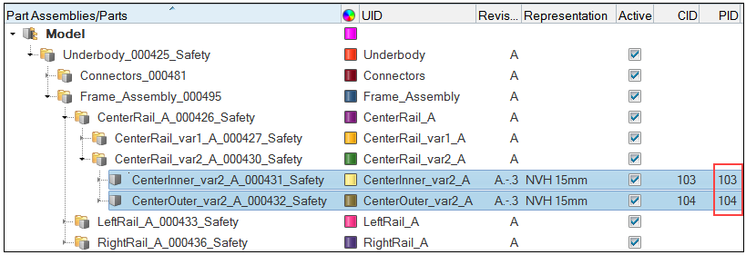

Modify Part Attributes
In this step you will modify the center rail part attributes.

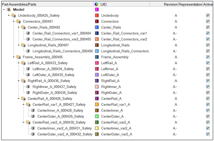

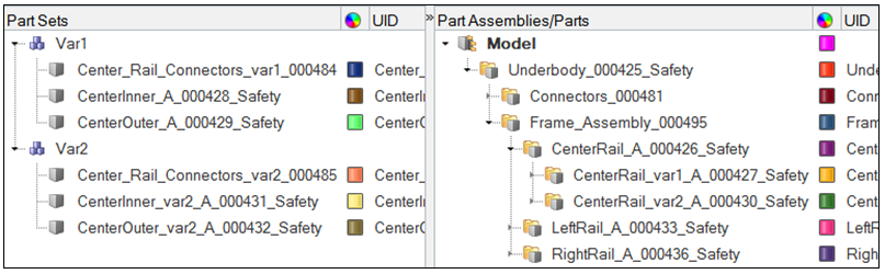

Create Part Sets
In this step you will create part sets Var1 and Var2 for Variant 1 and Variant 2 in the Part Set view.

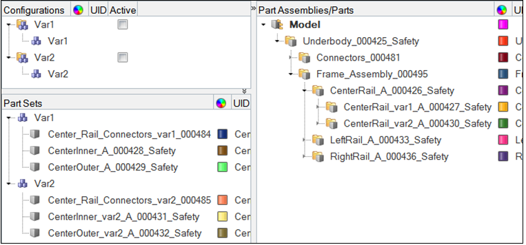

Create Configurations
In this step you will create configurations Var1 and Var2 for part sets Var1 and Var2 in the Configuration view.

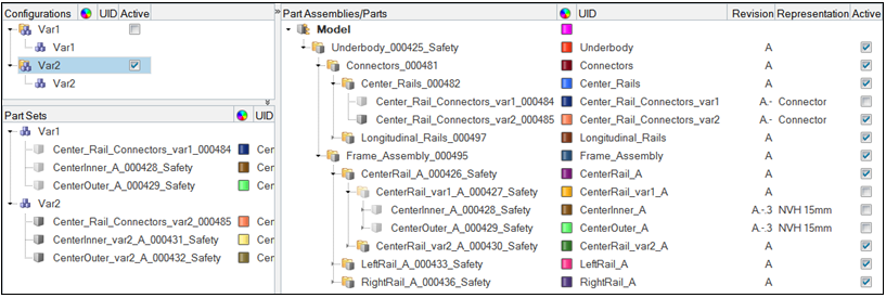

Activate the Var2 Configuration
In this step you will activate the Var2 configuration.

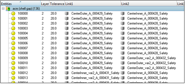

Realize Connectors
In this step you will realize connectors.

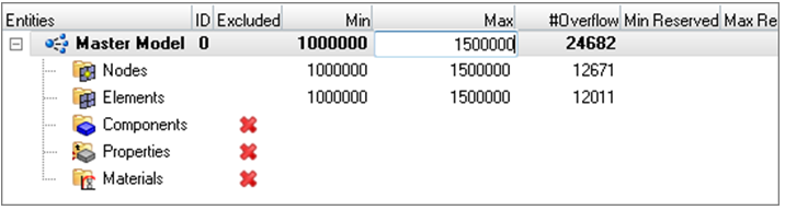

Renumber Nodes and Elements
In this step you will renumber nodes and elements.
