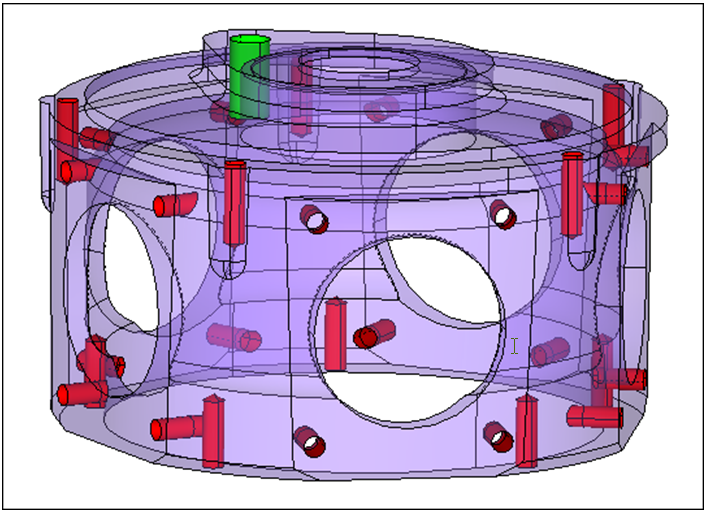

Organize and Clean Up Holes
In the Organize and Cleanup Holes step, you will organize the surfaces that form holes in the model.

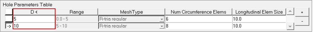

The TetraMesh Process Manager can automatically sort and organize holes into separate component collectors based upon their diameter. This will allow you to specify a mesh type, circumference element count, and longitudinal element size for different hole groups.
Mesh Holes

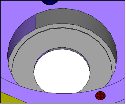

Organize Features
In this step you will organize and clean up features.
In the Organize and Cleanup Features step, you will highlight and organize features that require specific mesh controls beyond the overall mesh pattern that will be applied to the remainder of the part in a later step. You will use the organizational tool to place the required surfaces into their own collector or collectors, and set a mesh size and pattern requirements for each.

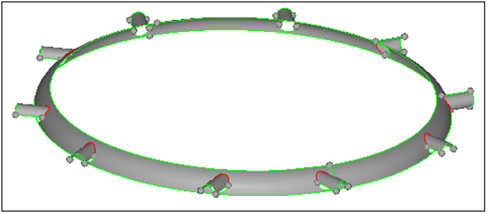

Organize Fillets
In this step you will organize and clean up fillets.
Often a better mesh can be achieved if your fillets are split down the center. In the Organize and Cleanup Fillets step, you will split your fillets based on a minimum and maximum radius criteria.

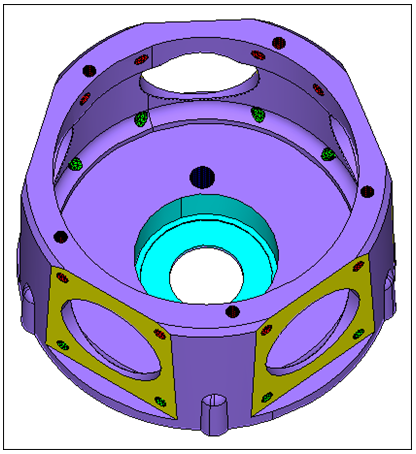

In this step you will organize and clean up the remaining portion of the model.
As the remaining surfaces are already in the component you wish them to be in, there is no need for further organization.

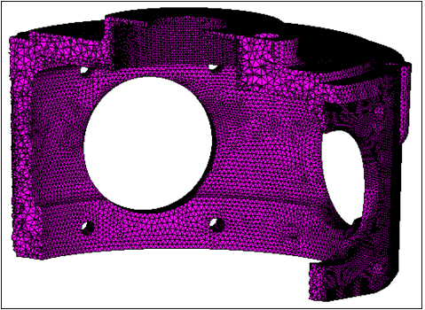

Tetra Mesh Model
In this step you will tetra mesh the model.
Tetra Meshing is the final step in the TetraMesh Process Manager Template. During this step, the model will be Tetra meshed. The Process Manager automatically opens the TetraMesh panel and pre-selects all of the float and fixed elements.
