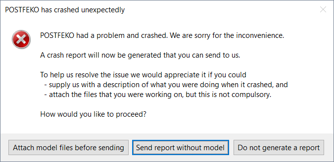

In the event of a crash occurring in CADFEKO,
POSTFEKO or EDITFEKO, the crash report utility generates a crash report. The crash report provides the
developers with details regarding the location where the crash occurred. This
information is not always enough to identify the and fix the problem. Providing a
model and the steps that reproduce the crash is more useful to the development team.
The crash report interface is simple and requires the following steps by the
user.
Figure 1. The crash report utility launches the dialog in the event of a crash to
indicate the options for proceeding with the crash report.
Select one of the following options:
To attach the model files and any other related files to the crash
report, click Attach model files before
sending.
If you are working on a confidential model and do not want to send the
model files, click Send report without
model.
If you do not want to generate a report and attach model files, click
Do not generate report and the crash report
utility will exit.

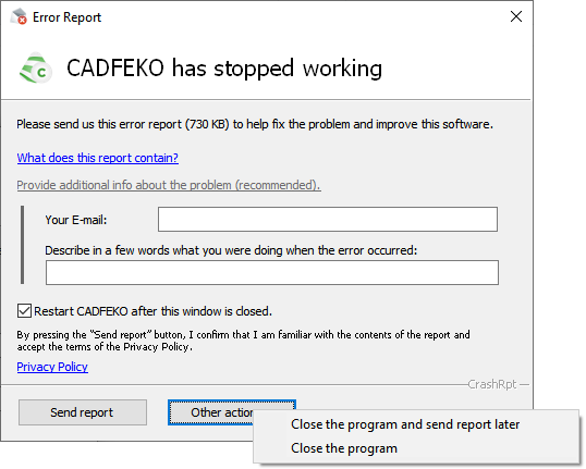

Figure 2. The Error Report dialog gives you the option to
either Send report or Close the
program.
Note: The file size of the report is indicated at the top of the
dialog.

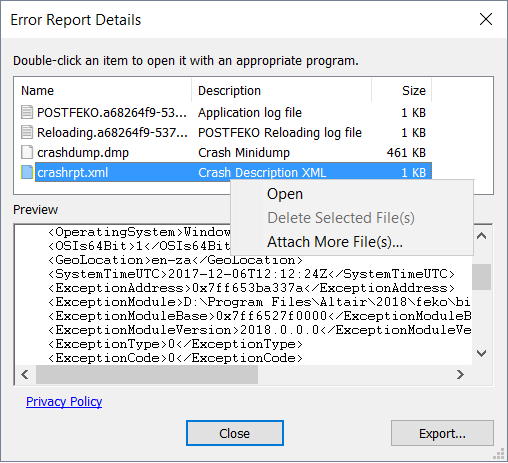

[Optional] Click What does this report contain? to view
the list of files contained in the crash report.
Figure 3. The Error report details dialog.
[Optional] In the Your E-mail field, enter your email if
you would like feedback when the crash has been resolved.
[Optional] In the Describe in a few words... field give
a description of the steps that you followed at time of the crash to help the
Feko development team resolve the issue.
[Optional] Select the Restart after this window is
closed check box to restart the software after the window is
closed.
Close the crash report utility by selecting one of the following
workflows:
To send the report immediately and close the dialog, click
Send report.
The report is sent by e-mail
using a built in SMTP client. If the network that the computer is on
does not allow this, an attempt will be made to send the report using
the default e-mail client installed on the computer.
To close the dialog and send the report later, click Close
the program. From the drop-down list,
select and send report later.
To close the dialog and do not send the report, click Close
select and don't send report later.
This option
should be used when the computer is temporarily disconnected from the
internet.
