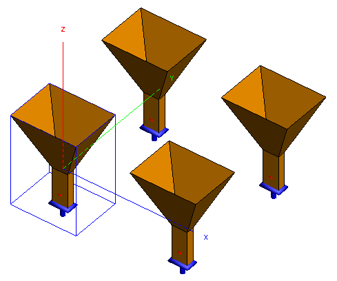

Array base element | Show / hide the finite antenna array base element.![]() Figure 1. A blue bounding box indicates the base element of the finite antenna array. |
