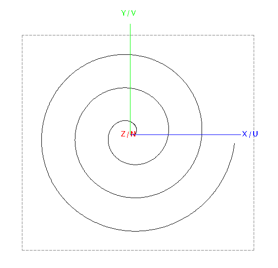

Create a helix.
- Definition method: Base centre, base radius, end radius, height, turns
- Origin of the helix (C): (0, 0, 0)
- Base radius (Rb): r1
- End radius (Rt): r2
- Height: 0
- Turns (N): n
- Label: Helix1
Figure 1. Top view of Helix1. -

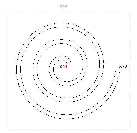

Modify the start radius and end radius:
- Base radius (Rb): r1 + w
- End radius (Rt): r2 + w
Figure 2. Top view of Helix1 and Helix2.

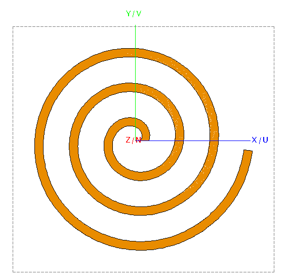

Connect the two helices to create a surface (loft).
Select Helix1 and Helix2 and loft
the two curves to create a surface.
Note: Do not select the Reverse orientation check box.
Figure 3. Top view of the lofted surface (spiral).

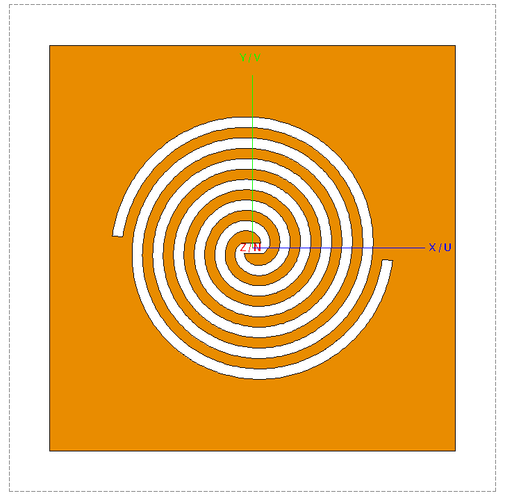

Create the conductive plate which will contain the complementary slotted spiral
antenna.
Create a rectangle.
- Definition method: Base centre, width, depth
- Base centre (C): (0, 0, 0)
- Width (W): width
- Depth (D): width
- Label:: Rectangle1
Create a rectangle.
Create the spiral slots in the conductive plate.
Subtract Union2 from
Rectangle1.

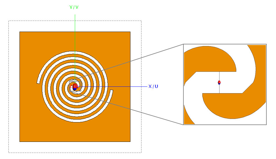

Figure 6. Top view of the two-arm spiral slots in a conductive plate.
Rectangle1.
Create the feed wire.
Create a line.
- Start point: (0, -w/2, 0)
- End point: (0, w/2, 0)
Create a line.
Add a wire port to the feed wire.
Figure 7. Top view of the complementary two-arm slot antenna showing the wire port at the feed line.
