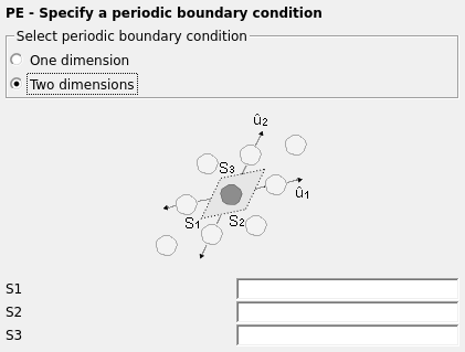

![](../../../../../../images/feko/user_guide/editfeko_cards/dialog_pe2.png)
Figure 2. The PE - Specify a periodic boundary condition dialog - Two dimensions

- One dimension
- One dimensional periodicity is used when the unit cell is repeated along a line. The unit cell definition is displayed in the dialog above depicting the One dimension option.
- Two dimensions
- Two dimensional periodicity is used when the unit cell is repeated to form a surface. The unit cell definition is displayed in the dialog above depicting the Two dimensions option.
- S1
- Name of the point S1.
- S2
- Name of the point S2.
- S3
- Name of the point S3. (Only required for two dimensional periodicity.)
