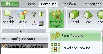

Defining an Infinite Ground Plane
Define a perfectly conducting (PEC) infinite ground plane. An infinite ground plane is an efficient method to model a large ground plane compared to a discretised, finite sized ground plane.
