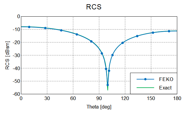

Simple examples demonstrating radar cross section (RCS) calculations of objects.

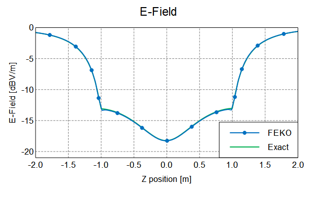

Calculate the radar cross section and the near field inside and outside of a dielectric sphere using the surface equivalence principle (SEP).
View and post-process the results in POSTFEKO.
