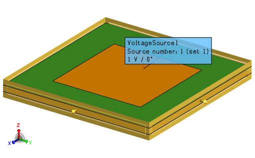

![](../../../../images/feko/example_guide/EG_A16_patch_array_pbc/intro.png)
Figure 1. A 3D view of a single element in an infinite patch array in CADFEKO.
