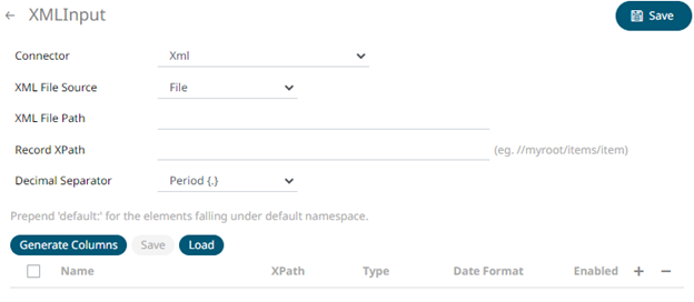

1. In the New Data Source page, select Input > Xml in the Connector drop-down list.
2. Select the XML File Source.
3. Enter the Record XPath (e.g., //myroot/items/item).
4. Select either the period (.) or comma (,) as the Decimal Separator.
5. Click
to the fetch the schema based on the connection
details. Consequently, the list of columns with the data type found
from inspecting the first ‘n’ rows of the input data source is populated
and the Save button is enabled.
6. You can also opt to load or save a copy of the column definition.
7. You can opt to click
. A
new column entry displays. Enter or select the following properties:
