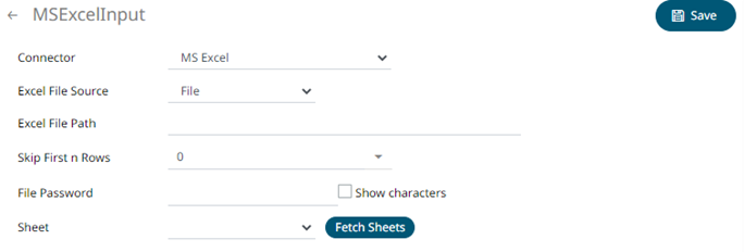

1. In the New Data Source page, select Input > MS Excel in the Connector drop-down list.
2. Select the MS Excel file source.
3. Select the number of rows that will be skipped in the Excel file from the Skip First n Rows drop-down list.
4. If the MS Excel file is password-protected, enter the File Password.
Check the Show Characters box to display the entered password characters.
NOTE |
The password is case-sensitive.
Otherwise, proceed to step 5.
5. Click
. This will populate the Sheet drop-down list
box.
6. Select the required sheet.
7. Click
. The new data source is added in the Data
Sources list.
