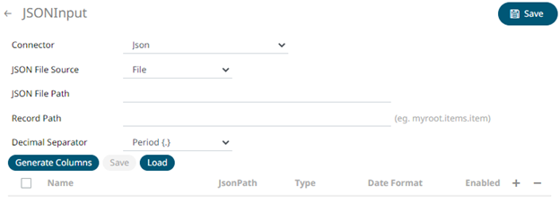

1. In the New Data Source page, select Input > Json in the Connector drop-down list.
2. Select the JSON File Source.
3. Select either the period (.) or comma (,) as the Decimal Separator.
4. Click
to the fetch the schema based on the connection
details. Consequently, the list of columns with the data type found
from inspecting the first ‘n’ rows of the input data source is populated
and the Save button is enabled.
5. You can also opt to load or save a copy of the column definition.
6. Click
to add columns and specify their properties:
Property |
Description |
Name |
The column name of the source schema. |
Json Path |
The Json Path of the source schema. |
Type |
The data type of the column. Can be a Text, Numeric, or Time |
Date Format |
The format when the data type is Time. |
Enabled |
Determines whether the message field should be processed. |
To delete a column,
check its
or
all the column entries, check the topmost
, then click
7. Click
The new data source is added in the Data Sources list.
