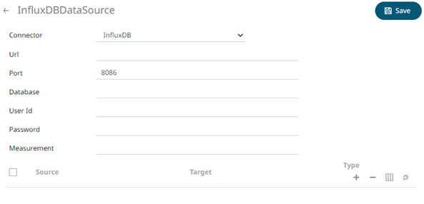

1. On the Data Source tab, select Output > Influx DB in the Connector drop-down list.
2. Define or select the following properties:
Property |
Description |
URL |
URL of the InfluxDB. |
Port |
The port running the InfluxDB HTTP service. Default is 8086. |
Database |
The name of the database that will be communicate over the HTTP(S). |
User Id |
The user Id that will be used to connect to InfluxDB. |
Password |
The password that will be used to connect to InfluxDB. |
Measurement |
The table name that can be used as measurement. |
3. You may opt to use the toolbar to complete the data source definition.
4. Click
. The new data source is added in the
Data Sources list.
