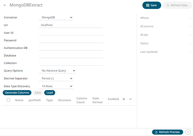

1.     On the New Data Extract page, select MongoDB in the Connector drop-down list.
2.     Enter the following properties:
Property
URL
Enter either:
·         localhost if the database resides on the same computer, or
·         enter the IP address and port of the computer where MongoDB is installed (e.g., 192.168.1.1:27017). If no port is specified, the default is 27017.
User Id
The user Id that will be used to connect to MongoDB.
Password
The password that will be used to connect to MongoDB.
Authentication DB
The database where the user is created.
Database
The database that will be used.
Collection
The collection that will be used.

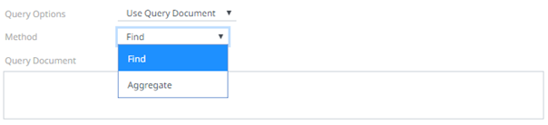

3.     You can also opt to make the Query Document feature of MongoDB to be available in the Panopticon Visualization Server. Select Use Query Document in the Query Options drop-down list.
This also displays the Method drop-down. Select either Find (Default) or Aggregate.
When Aggregate is selected, you can add all the columns generated by aggregation in the schema.
In addition, the MongoDB command line interface displays query operations with a JSON style syntax.
Enter your desired JSON query document. Refer to http://docs.mongodb.org/manual/tutorial/query-documents/  for more information on the Query Documents feature on MongoDB.

5.     Select either the dot (.) or comma (,) as the Decimal Separator.
6.     Select the Data Type Discovery. This property specifies how many rows to fetch from the input data source, when auto generating the schema after clicking  .
7.     You can also opt to load or save a copy of the column definition.
8.     Click . A new row displays in the JSON list box. Enter the necessary information for each column.
