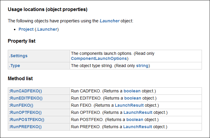

Run the Solver by searching and navigating the documentation. Enable a parallel solution, save the model and run the Solver.
The results return in response to the runfeko query includes RunFEKO (method).
my_project.Launcher:RunFEKO()
